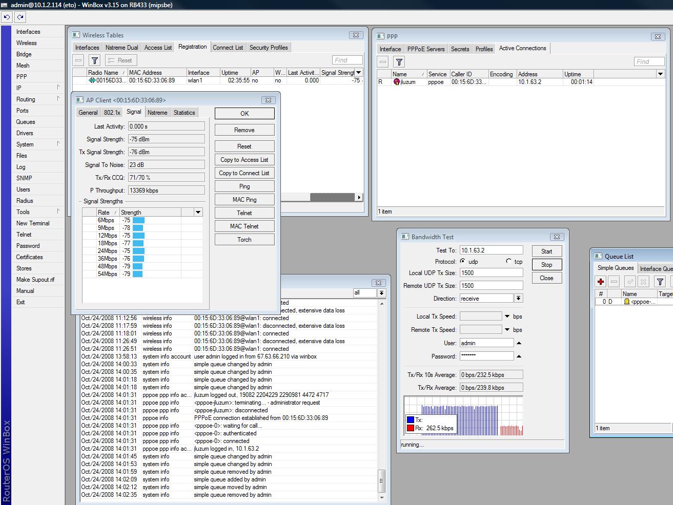

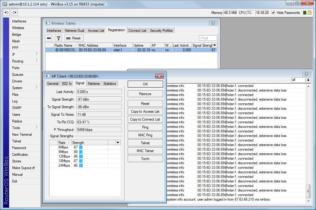

In mikrotik I disabled power saving on both ends. Signal is -90/-89. Sometimes they are not even connected. Customer is about 5 miles away. Power is set to default on both sides. Using latest version of routeros 3.15. When I do a bandwidth test. I found her signal went to -74/-72. Once I stop the bandwidth test for some time. The signal goes bad again. How do I disable power save feature in the XR card?
This is my situation. I am using latest routeros and do you see my signal dropping. Signal only better when using bandwidth. I am confused on what is causing this.
Look below. This is exactly what is happening. How do I stop it? This would be greatly appreciated.
The top picture is the working one and the bottom picture is the none working one. The working picture is after I did a bandwidth test. Remember the customers signal keeps working after some time. Then signal drops when not using internet.
