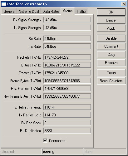

I have made nstreme link,but no success.
Everythig looks good,but Btest only 6M with high latency.
Look at the picture.
I use:
distance:6km
cards:ubiquiti XR5
antennas:ubiquiti Rocket dish
RB:RB600 with nstreme
site A:RB600 + 2xRX5 <=>site B:RB600 + 2xRX5
TX power default.
Hello
your problem is constructive interference meaning your signal is too strong,anything under -50dm will cause latency and bad throughput.Try adjusting your tx power on your radios to a lower amount such as 15db(all rates fixed) which should take your signal to around -55dbm or so.Once that is done try doing a bandwidth test again as well as a ping test.
ps:dont run the ping test while doing the bandwidth test or else you will get high latency,if you want to do a ping test while doing a bandwidth test then set your bandwidth test to a fixed amount so that its not maxing out the radio’s capacity.
