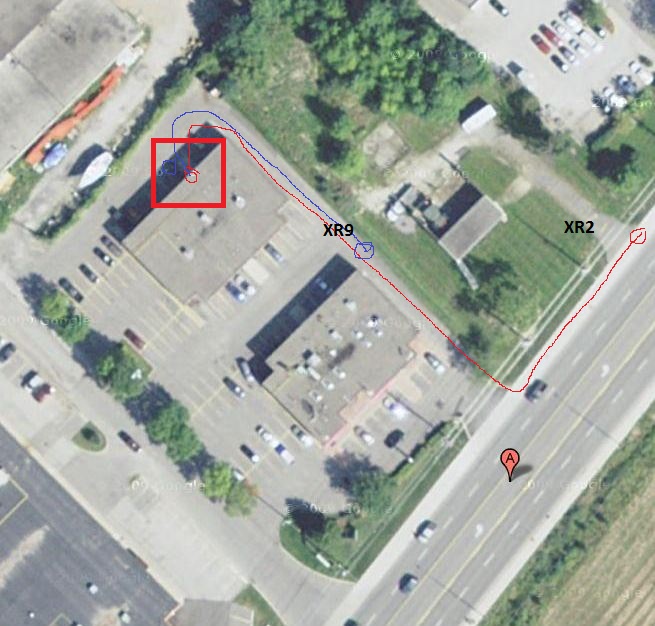

I’m trying to use 2 of these cards with mikrotik boards, but the range is just terrible. I’m getting about half the range of the XR2. The throughput starts off fine at very close range (~15 feet) but it dies off very fast. Goes down to about 200kbit/s in about less than 50 feet. I tried all the recommended frequencies and a little more but no luck. My spectrum analyzer is not showing anything on the frequencies used. I know it’s not line of sight, but I really thought the 900 should do better in NLOS than the 2.4. On the picture you see how far each gets. The red square is the starting point. Both antennas are 5dbi rubber duckies. One end at 4 feet high, at at 6 which makes the XR2 even more impressive. The 900mhz antennas are 3dbi. At the end point in the picture, with 2 fences a concrete building and some trees and bushes, I’m still getting 8mbps…
