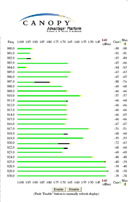

You can get a 900mhz Motorola Canopy SM on ebay for around $300. Has a built-in Spectrum Analyzer that works very well.
I have a development in the middle of a forest and I still pick up 900mhz devices. I would never trust a reported noise floor. Always use a spectrum analyzer.
I’ll have to check them out… I think I’ve already heard this, but can you confirm that the Moto’s analyzer does actually report generic noise? I know the mt’s don’t do a good job of reporting non-802.11 noise…
It is an actual spectrum analyzer.
