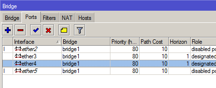

you do mean the following don’t you?
my Nanos are in ether3 and ether4
Yep. That’s what he means. It’s very simple to do and lets your lan bridge use fastpath, where bridge filters disable fastpath.
Essentially, what horizon does is say that if a packet is received on a horizon (you set horizon=1), then it may not leave the bridge on any port with that same horizon value.
So all horizon=1 are blocked from talking to each other, but they can talk to all other horizons (and ports without a horizon).
