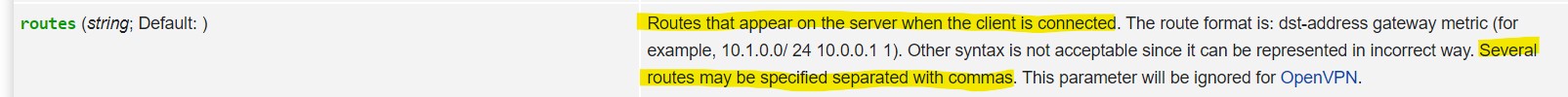

The routes parameter in secret is for the client routes, not the server routes.
https://wiki.mikrotik.com/wiki/Manual:PPP_AAA#User_Database
routes (string; Default: )	           Routes that appear on the server when the client is connected. The route format is: dst-address gateway metric (for example, 10.1.0.0/ 24 10.0.0.1 1). Other syntax is not acceptable since it can be represented in incorrect way. Several routes may be specified separated with commas. This parameter will be ignored for OpenVPN.

Thank you @bpwl for your response.
I think I might be confused though. In my setup, the client is the remote macOS machine, and the server is the MikroTik router, is that correct?
If so, the routes parameter documentation seems to indicate that this route is installed on the MikroTik router itself whenever the remote client establishes the connection, not on the remote client.
Yet, I am looking for a way to automatically install the route on the remote macOS machine when it establishes the VPN connection, is that possible?
