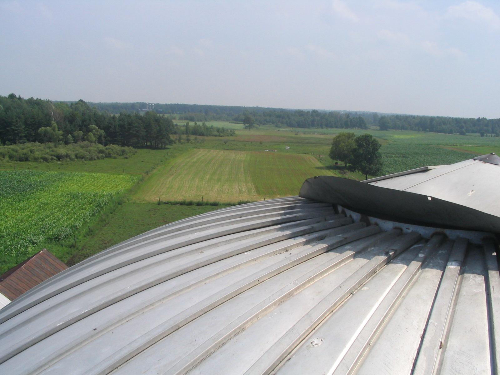

I have attached a pic of what it looks like ontop of my silo, not a good pic, and not near the direction of the clients, add another 50 foot ontop of this pic and you have my tower, I mite post a pic later. Funky looking thing. Here is a couple pics of my location were i live, i Live in Waddinton NY and yes you can litteraly see Canada from waddington (my location)

2nd pic A pic from the top of my silo.
