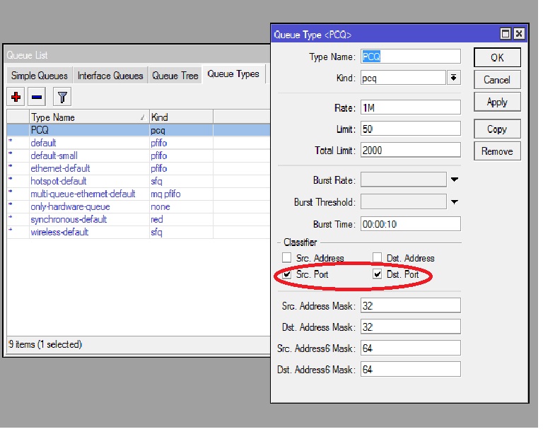

seems like something is wrong with PCQ classifiers - recheck your config
I used Mark connection, then Mark packet to mark the whole connection, and then mark packets of that connection(As u said). Also I used the configuration as in the images(Queue Tree & Queue Types).
In PCQ classifiers, I used Src.Port and Dst.Port, I will try to use Src. Address and Distination Address.
What u suggest me to do?
in Download queue, you need to use Dst. Address classifier, in Upload - Src. Address
It works fine now, thanks alot Chupaka.
