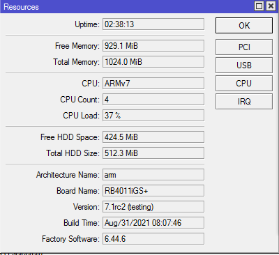

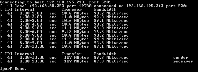

I finally got my RB4011. So I did some Iperf3 benchmarks via ZeroTire link. As you can see on screenshots I got around 90Mbits. CPU load is around 40%. I think it’s not bad.
I was testing via 1Gb link. I also found out that ZeroTire supports AES hardware offload only on ARM64. So I think we have to wait until ZeroTire start to support hardware offload on ARM, then maybe we will get it on Mikrotik (since Mikrotik supports ZeroTire only on ARM based devices). This is from ZeroTire Relase notes:

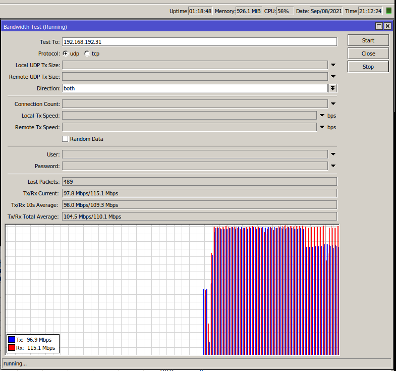

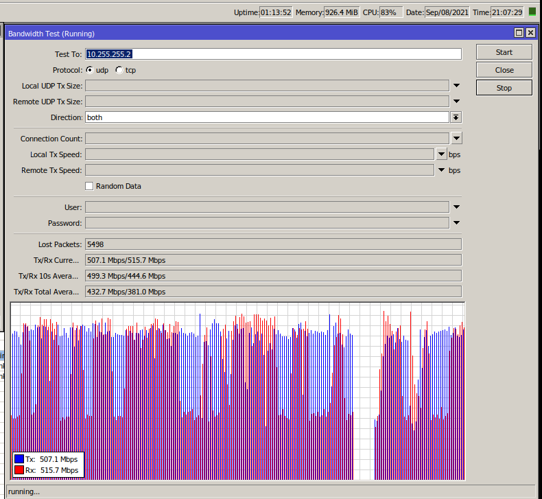

RB4011iGS+5HacQ2HnD to RB4011GS+ via the same switch. Wireguard vs ZeroTier.
Wireguard about 450/430 Mbps with 80-90% CPU.
ZeroTier about 106/109 Mbps with 55% CPU.
Direct bandwidth test is 950/950 Mbps with 75% CPU.
