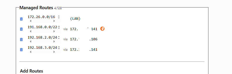

I have tried this also. It gives a symbol. That symbol states No Private IP Space. Clients will need to set Allow Global.And If I do so into the client (mirotik) does not allow to ping teh internal addresses…
The icon indicates that the chosen IP address range overlaps with a public (global) address space. Avoid using a public IP address spaces for your own LAN or the Zerotier network, instead choose a sufficiently large subnet from 10.0.0.0/8, 172.16.0.0/12 or 192.168.0.0/16 (or allow ZeroTier to pick one automatically for you). Use a service like “IP Subnet Calculator” or “whatismyipaddress.com” to verify that the selected subnet for your ZeroTier network is private. This will eliminate the need to “allow global” access. If you configure ZeroTier to use a public address space using “allow global”, IP routing can become very complex and difficult to manage correctly.

The subnet is 191.168.0.0/22 and is public indeed.

If you don’t own the entire 91.168.0.0/22 range, it’s probably wise to change it to something else. Otherwise, you risk routing your network traffic to the real owners out there on the interweb..
I will do so. Its mandatory now…
