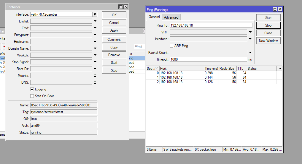

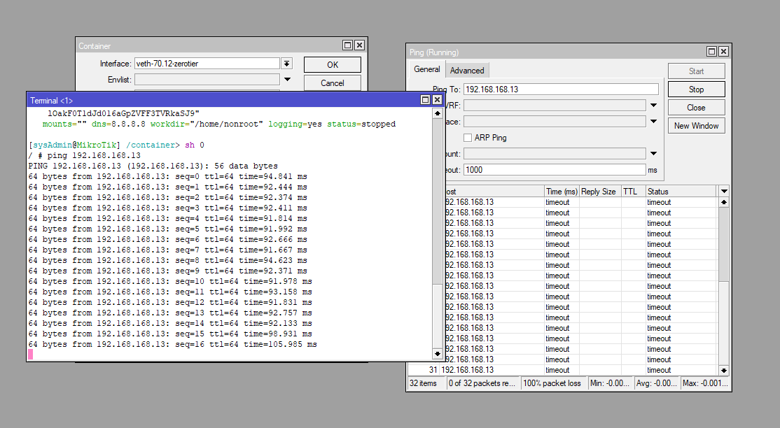

hi, I have the same problem with accessing another zerotier device.
I can ping the docker zerotier ip but can’t ping the another device ip.
