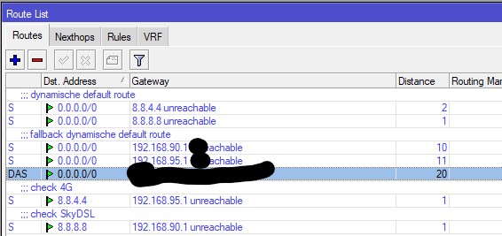

It 's all about detecting , better than pinging the gateway/modem, if the route is usuable for Internet traffic , by pinging far away well known hosts via a route with “scope=10, target scope=10”
http://forum.mikrotik.com/t/question-about-recursive-route/136156/1
I know by that route check (on 8.8.8.8 and 8.8.4.4) if my two gateways 192.168.90.1 and 192.168.95.1 have an operational connection to internet or not.
If not, they become unreachable (something that could be propagated through OSPF I assume)
In your case, 1 tested route per gateway at opposite (geographical) ends of the ring.
