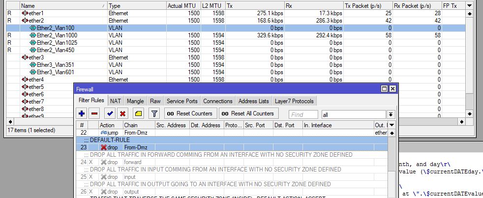

So I ran the script on a mikrotik with no default config, added my vlans/subnets/dhcp and etc, bu when I enable all of the rules (particularly the three rules that “DROP ALL TRAFFIC * TO AN INTERFACE WITH NO SECURITY ZONE DEFINED”. Is that because I have vlan interfaces? If so, how do I add the vlan interfaces to the inside zone?
Current port assignment: Ether1 (Outside), Ether2 (Inside), Ether3 (DMZ).
Vlans on Ether2 and other test Vlans on Ether3.

But if I wanted to fix my current setup, is there an easy way to include the can interfaces? I tried using bridge interfaces, to encompass all subinterfaces (hoping it would include the vlans). That didn’t work.

Eric yes you need to add the vlan interfaces to a zone, the rules in there had defaults, the one your mentioned basically drops everything not assigned to a security zone.
anyway adding interfaces to a zone was kind of complicated when I wrote that configuration, that’s why there’s a function loaded that does this all for you.

I did try $zbf add 1 Ether2_Vlan100 and is says something like l failed to add, could not locate interface.

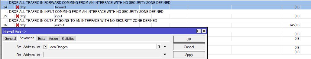

Another update, I added a subnet to the source IP address for each of those three DROP rules and it worked. In the screenshot II had created an AddressList for the local subnets. This is probably not the correct way to have do this, but is works for now. :slight_smile:
