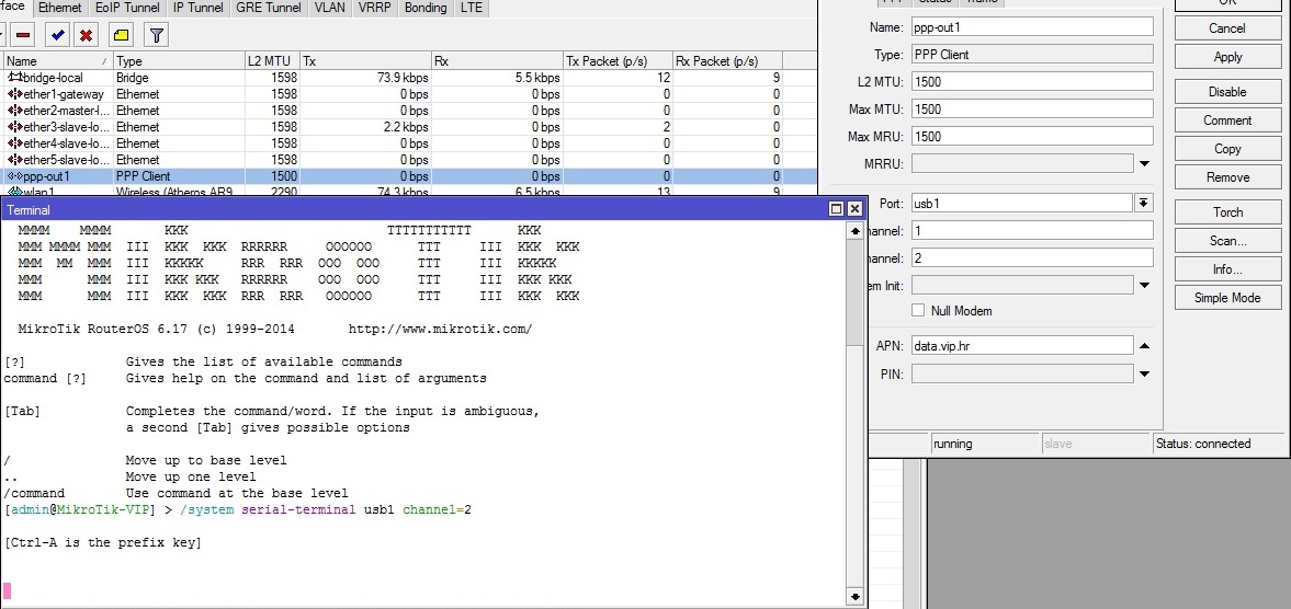

I tried that buth I can’t write anything, only works CTRL-A and q to exit.
Sent from my HTC One using Tapatalk
If it won’t let you type anything then you are trying the wrong channel.

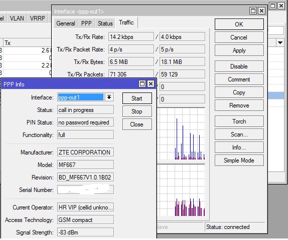

Please attach a screenshot of the ppp-out1 interface (without the info box covering it).
Hi, here is screenshot.
Hi, here is screenshot 2.
I’m not sure why the info box will get the detail but accessing the channel direct won’t.
Until someone else who has this modem or another ZTE posts, the only think I can suggest is to just try again with a different channel from 0 up to how many the modems has.
