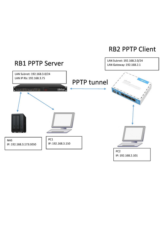

Goodmorning everyone.
Introduction: I insert a picture of the network connections with the names of the devices named below Image
I have a routerboard (in picture called rb2) with 4G connectivity with ISP IP under NAT. To reach its interface from the outside I thought to create a PPTP tunnel between it and my main routerboard (in picture called rb1).
I created a PPTP server on rb1 with these parameters (cleaned):
/ppp profile
add bridge=bridge1 local-address=192.168.3.75 name=hap01
/interface pptp-server server
set enabled=yes
add address=192.168.3.75/24 interface=bridge1 network=192.168.3.0
/ppp secret
add local-address=192.168.3.75 name=hap01 password="***************" \
    profile=hap01 remote-address=192.168.3.43 routes=\
    "192.168.1.0/24 192.168.3.75" service=pptp
set name="rb1"
The IP 192.168.3.75 is the IP of rb1 which corresponds to the gateway of the rb1 LAN. the IP 192.168.3.43 is the IP I want to assign to the PPTP interface on the rb2.
On rb2 I created a PPTP client with these parameters (cleaned):
add name="bridge LAN"
add name="bridge VPN"
/interface pptp-client
add add-default-route=yes connect-to=[rb1 ISP Public IP] disabled=no name=VPN-Client \
    password="***************" user=hap01
add name=dhcp_pool1 ranges=192.168.2.100-192.168.2.200
add address-pool=dhcp_pool1 disabled=no interface="bridge VPN" name=dhcp2
add bridge="bridge VPN" interface=ether4 multicast-router=disabled
add bridge="bridge VPN" interface=ether5 multicast-router=disabled
set name="rb2"
I put the PPTP interface to masquerade and connecting any device on the rb2 bridge ports everything works and I navigate using the ISP public IP of rb1.
With a pc connected to rb2 LAN (in picture called PC2) trying to ping a device connected to the rb1 LAN (in picture called NAS) it answers and I can access it. From rb1 terminal trying to ping 192.168.3.43 (PPTP interface rb2) it responds, while if I try to ping it from a device under the rb1 LAN (in picture called PC1) it does not respond. I don't even see the IP 192.168.3.43 in the rb1 ARP list.
What am I wrong? I have minimized the exposure of my configurations to avoid confusion. If you need further details on configurations, please ask
Thanks so much everyone

ARP only applies to IP-over-ethernet. If you overlap subnet address on ethernet and non-ethernet interfaces then use proxy-arp on the ethernet interface, or parent bridge if the interface is a member of a bridge, so the Mikrotik replies to ARP requests from ethernet-connected devices on behalf of the non-ethernet-connected ones.
You should not need NAT, just appropriate routes at both ends - a Mikrotik VPN server will not push routes to a client.
Presumably 192.168.1.0/24 is some other network not shown - the PPP secret routes statement is missing a distance, and you can use a placeholder for the gateway, so routes="192.168.1.0/24 0.0.0.0 1"
With incomplete configurations there may be other issues. Finally, don't use PPTP as MSCHAPv2 and MPPE are insecure.

Thank you so much for your answer.
The 192.168.1.0/24 network is a secondary network of rb2 which does not concern the PPTP tunnel (it comes out with the natted IP of the SIM 4g).
I changed the PPTP routes as suggested by you:
But the situation does not change. Trying to ping from the windows prompt the result is this:
C: \ Users \ simon> ping 192.168.3.43
Ping 192.168.3.43 with 32 bytes of data:
Reply 192.168.3.107: Destination host not reachable.
Ping statistics for 192.168.3.43:
     Packets: Transmitted = 4, Received = 4,
     Lost = 0 (0% lost),
As you can see I ask for the ping on IP 3.43 but I am answered 3.107 (I don't know why)

I would expect 192.168.3.107 is the address of your PC, did you set arp=proxy-arp on bridge1
The routes parameter was a separate issue I noticed.
I have enabled the proxy arp on bridge1 interface and now it works!! Thank you so much for your help! You have been very kind :)
