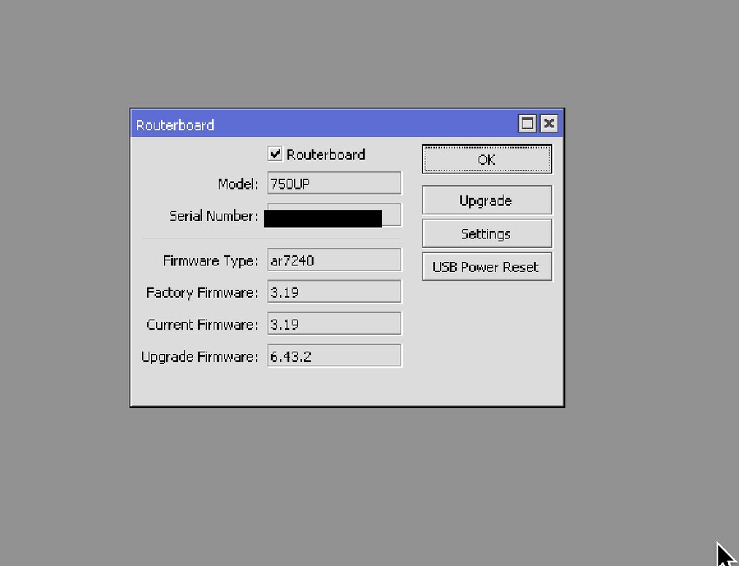

I have updated two RB750UP ros 6.43.2, when I try to update the firmware the RB stops working and needs a full reset.
The current firmware on board in 3.19, I would like to upgrade it to 6.43.2 :)
I tried a search on the forum but I did not find any information.
I add:
at every reboot I have to completely reset... it is not normal!!!
