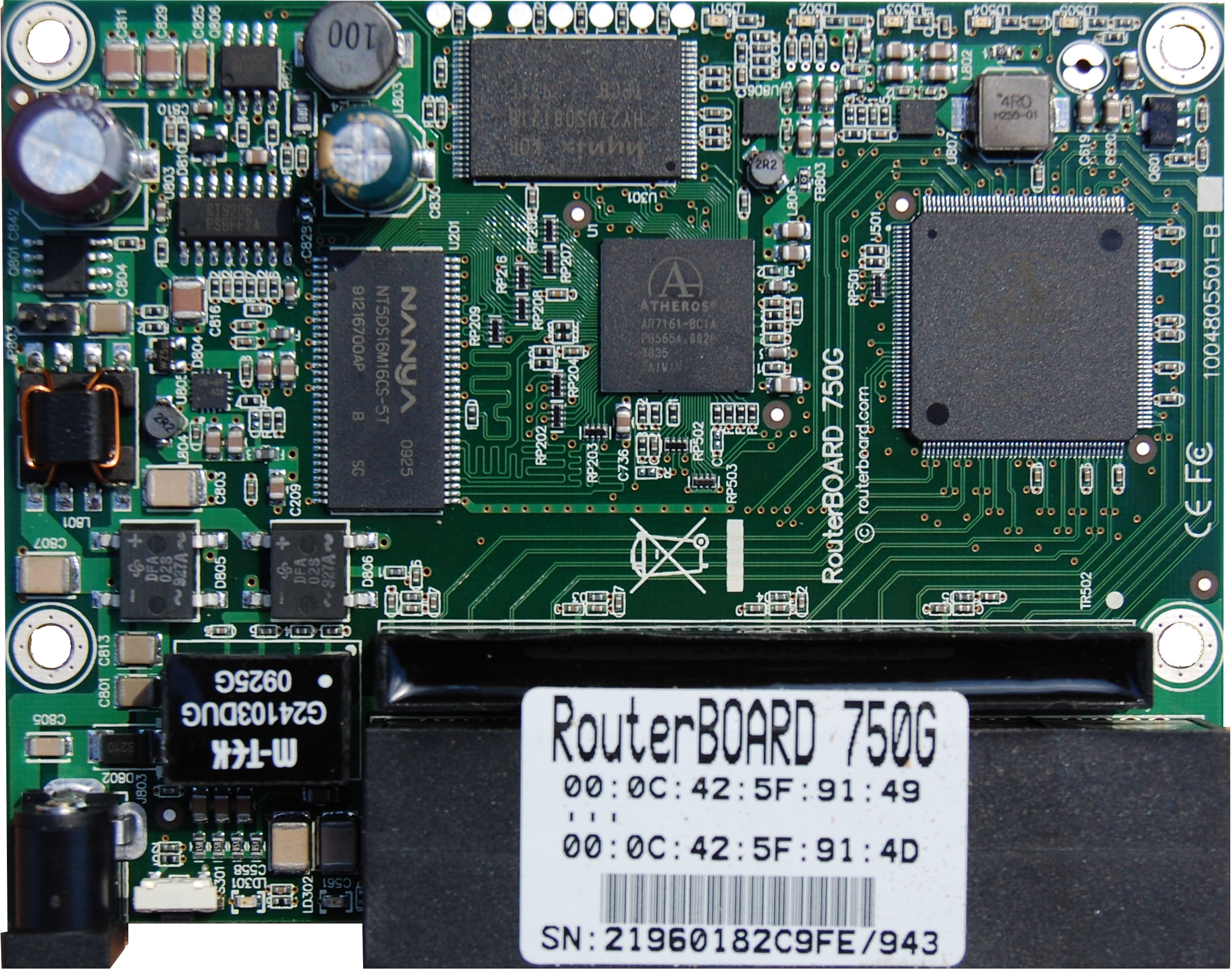

the last two months i had 5 rb450 with the same problem. It stops to work , and them the eth4 and eth5 leds turns on a very weak light. All these RB450 had been working for about 8 to 10 months.. :( when opened, i found ttwo capacitors leaked and blowed ( su'scom 560uf 6.3 volts..) I just bought about 50 rb450g and found out that they have the same capacitors... should i be worried?? is this a known issue? the problem is the lost of reliability :( .
There's anyway to fix the broken boards?

I've had 20 RB450s with blown capacitors. The reseller has been successful in replacing some, the others I've just gone out and bought the 6.3v capacitor (I upgraded to 680uf) and soldered them in myself. You'll need 3 per board.

please post pictures of the bad capacitors

I'll have to try to find a board that I haven't repaired yet. However I can point out the capacitors I had to replace in order to make the board operational again.

the bad capacitors are always the same ones? post which ones, and a picture of the problem, if you find such board again

I purchased 20 RB450s in 2008 from Tom at Roc-Noc. During 2009, each of the 20 failed. Tom mentioned that Mikrotik was aware of the capacitor issue and would offer a replacement of the 20 RB450s. In that time I've received a partial replacement. Sadly, due to the substantial delay in receiving the remainder of the RB450 replacements I've had to implement my own repairs, replacing the 3 capacitors in the picture below.
If your RB450 fails, you will see 3 bulging and brown capacitors in the areas I've pointed out below. Replace those and your RB450 will be functional again as well as not having the issue where a rapid power outage will cause the board not to reboot.

We have seen only the Green one damaged. It would be great to see actual damaged ones ...

The three brown capacitors in the picture I uploaded are the replacement caps I purchased locally. Tom at Roc Noc may be able to take a picture as he has several blown RB450s on his hands.

I've got the same problem, here's some photos of the bad caps
My RB450 has been in continuous use for about 1.5 years now. It was also probably running a bit hotter than it should have been (sitting on top of a Linksys AP that throws of a lot of heat).
I'll probably just resolder some new caps, as I always like an opportunity to bust out my Weller. :)

I have about 20 of these back from customers. Here is one of them. Notice the leaking electrolyte and the three bulging electrolytic caps.

If you can make it fit, try to get caps for a higher voltage instead of higher capacity. It could be that the original ones are a bad batch but so many?? may be at a higher voltage they never fail again.
The trouble is that for a higher voltage they are bigger, so take the board to the electronics shop to see if they fit before you buy.
EDIT: just to be sure, measure the voltage over the capacitors while the board is turned on... you should see a DC voltage. Check if the polarity is right and how high that voltage is. Now you know if the caps have a too low voltage rating and if they are mounted at the right polarity!!

new batches are already made with different parts and will not have this issue. as soon as we got first problems, we switched supplier immediately

Swap them out with higher qualtiy caps and all is well.. ( If the unit hasent been run too long and damaged the power circuit..)
Keep the values the same ( Voltage can be a bit higher )..
Cap "values" "CAN" be critical... if it is a passive filter cap then not so much,,
If it is part of a "charge pump" circuit then it can be very critical... (Can affect output voltage or load on charge pump voltage controler)
Change out sould only take about 3 - 5 Min each... An experianced tech with a bit of practice can do them all in about 5 Min..

I just had this happen to a RB450G I own. Here are the pics:
I will have had the unit for a year next week. I bought it from rocnoc.com, so hopefully they can repair/replace it for me. Otherwise I'm going to have to learn to do some soldering I guess. I'm not very happy about this :(

I don't think you will. This is the first RB450G that we have seen with bulging caps. I am hoping this is an anomaly.
The 450G power circuit design is much different from the older RB450 power circuit where we have seen all the cap problems.

A very small number, we found the problem and changed supplier immediately

yes, that's what we did

I also have the problem with a RB450G I replaced with another 630uF 16V and works fine yet..
an another things Im seeing the same capacito 6.3V 560uF with the same color, manufactor on RB750 and RB750G

I ran through all my faulty RB450's, and they all seem to originate from the same three shipments received in 2008. It would seem that the issue is not present in newer batches of RB450.

My Main router which is an RB450 seems to be having the same problem. I opened up the case and noticed "brown" stuff leaking out of the 3 capacitors previously noted in previous posts.
I'm going down to Fry's to look for replacement capacitors.
What information should I give the guys at Fry's so that I get the right replacement capacitors?

We've had some RB450G's hit by power surges previously that I've fixed myself.
Had no problems replacing the 6.3v 560uF original capacitors with *similar* ones.
In this case the replacements are 10v 470uF and the 3 replaced are the ones in a line in the middle of the board.
Gives me a chance to practice my soldering skills and teaches people why they should invest in surge protectors hehe.

Lead spacing and package is too big. Use 470uF - 680uF and 6,3V - 16V capacitors with 3,5mm lead spacing.It's posible use 5mm lead spacing but need aditional lead forming. Don't forget about polarity.

Found the Capacitors at Fry's. Replaced them on the board, and now I'm operational again.
Thanks to all for your assistance !!!

We've also have about 50 RB450 and changed nearly all of them.
At Some I must resolder new Capacitors (I've took 1000uF 16V, the last one who fits into), cause of unavailability for spare Boards and the RB750 I've ordered instead are still not arrived (our internal Spare Parts already used at customer side :-( cause we never had so much Spare Units for so much dead ones)
Also someone wrote to Power just with 12V instead the default MT PS with 24V cause then the are cooler.

I had the same problem with the caps.
I changed the 3 green one caps with other, but with different value: 470uF 16V
Now the Router boots, with green led blinking and beep, but the 5 ports are already down.
I have the led on the ports lighted very weakly, in decrescent order from tha fifth to the first.
If I connect a computer at any port, the criteria doesn't come up.
Any idea about the causes?

470uF@16V is OK. Check again your soldering carefully that you not make any shorts. Else try replace that one cap. what located nearly from swich chip.

Effectively, after the replacement,the RB worked fine.
All orange led in the port socket blinked and connected with the WinBox.
But now, after about 2 weeks from replacement where the RB was powered off, the problem with the ethernet port is yet the same.
About the soldering, I had some difficult to remove the old ones. The last problem was cleaning up the holes.
At the end I used the SMD plots for solder the folded reophores of new caps
At the moment I'm not able to try to change the caps near switch chip, because I'm out for job.
I will do it when back at home.

We've also changed the 3 capacitors at about 10 boards last 2 weeks, hoping the'll work fine :-)
Capacitors I used is some posts above, changing was not the easiest, but also not a too hard work, we made this in field in the car.
I think some capacitors may have a little bit thicker pin, and therefore it's hard to clean the hole good enough.
Unsoldering with a very thin soldering iron at 450C worked fine.

We just replaced bad caps on 3 RB450's. Found a bad motherboard with comparable caps that we could re-use.
It wasn't to bad to do just a PITA that we have to do it.... Seems as though there was some power hack for the RB100's as well?
I really wish the RB line was a bit more hardened for longer MTBF.

Not sure exactly when I bought this RB750, but it's the second one to fail (at around 6am yesterday) in the exact same place in the network.
On reading this thread, I've swapped out the 24V adaptor that was powering it to a 12V for the replacement RB750. Fun start to a Monday morning...
You do not have the required permissions to view the files attached to this post.
