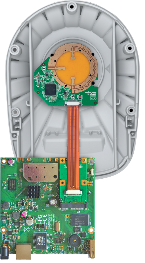

@Lakis many thanks for your Antenna suggestion which I must try, but one site to site is only 5KMs apart so i will use RF Elements horn with Mikrotik adapter
Those are intended for sectors... for a PTP either a UltraHorn TP or UltraDish TP would be better
UltraHorn TP
UltraDishTM TP 400
Coupled either with a simper 5n radio
or a
TwistPortTM Shielded Adaptor V2 for RouterBoard + routerboard if AC is desired.
Those are the most clever and apparently most carefully engineered while still not so expensive shielded antenna systems to avoid co-location interference I've found... have had them in my hands but each time I tried to source them, no one had all the required components in stock.
Nv2 got better in terms of interference on AC chipsets, but still, it makes a night and day difference in Nv2 performance and stability, so investing on shielded ones pays quickly.
Anyone tried them?
