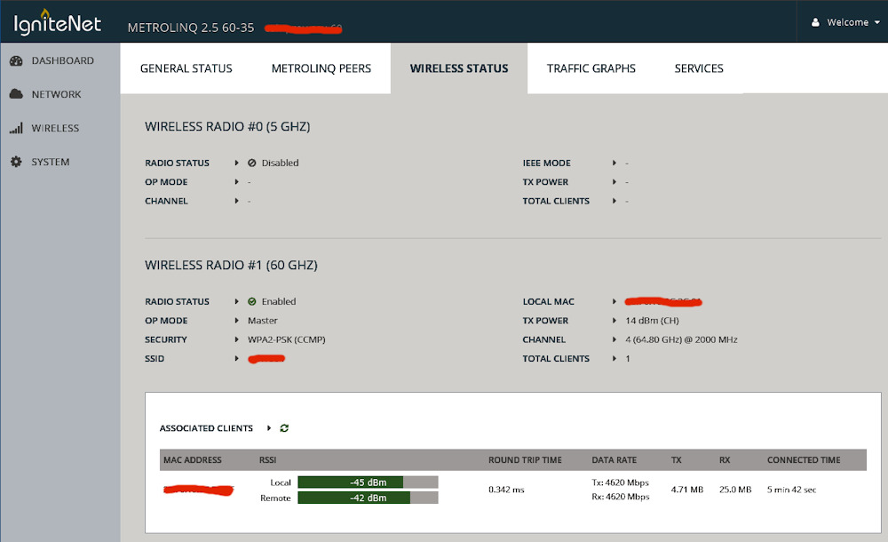

Installed a LHGG-60ad link a few days ago. Couple questions for those that have some of these up:
1) Is there an SNMP OID for the RSSI? We are graphing signal and MCS but I prefer to capture RSSI.
2) What are you doing to aim? I have aimed Siklu, IgniteNet and other millimeter wave gear but the aiming for these is different. I feel like there is beam steering on the AP and it makes it very hard to aim with beam steering on. I'd like a more responsive RSSI meter or another method for aiming. We keep hitting side lobes but the numbers are not very responsive. Are there tricks or can you turn off beam steering (if it's on)?
3) Where do I adjust TX power? We are a 233 meter link and I think "default" power is too strong. We see lots of fluctuations with signal.
Firmware is 6.42.6 Not wanting to run RC's on a production link...

1300 meters link with latest Metrolinq firmware:

There is no point having MCS12 when we are limited by GigE interface (I'm sure current hardware can do it, but there is no point why go that high). Instead of making cheap 100Mbit/s CPEs, Mikrotik should release SFP+ version or something like wired 5Gb/s. Also reducing modulation speed to get more channels would be nice, there is no point wasting entire current 2GHz channel to serve a few 100Mbit/s clients....
I could be wrong but I think regulations mandate the use of 2Ghz channels in that band.
(and the Metrolinq has a 2.5G ethernet port)
I know Ignite since 2015, but Mikrotik doesn’t have any 60G Device with More then 1gig port.
Channel widths could be Hardware problem but no regulation problem!
