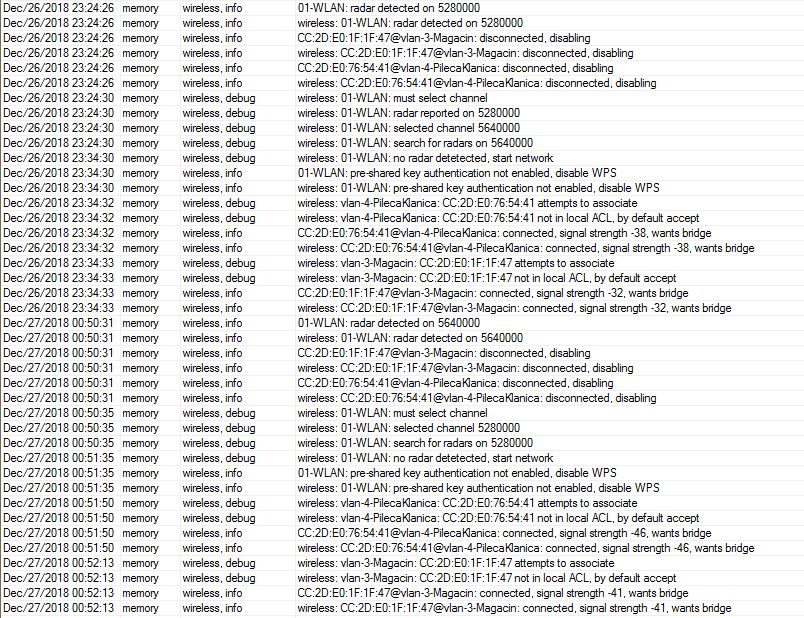

Hello everyone,
I have problem after change some options in wireless card. Change is maked in section Channel Width (from 20/40/80MHz eeeC to 20/40MHz eC), Frequency (from 5825 to 5680), Country (from no_country_set to Serbia).
Problem what I see is:
Configure on AP & Virtual AP & Station:
AP (just bridge becouse we have virtual ap)
Virtual AP
Station
Does someone have solutions to this problem?

On DFS Channels you have to deal with this
You choose a frequency and when the AP detect radar on this one, the AP select new channel
I change Frequency on station to auto and after re registration on AP, status Channel is changed to 5280.
So, that will resolve my problem? (This problem is show once per day, I need to wait to be sure)

My problem is not resolved :(

It is not a problem, it is unexpected behaviour (for you). Switching channels is de Dynamic part in DFS. The Wiki: https://en.wikipedia.org/wiki/List_of_WLAN_channels gives you an overview on all allowed channels you can select. Perhaps you can do a WiFi scan with a client to find out the best channel?

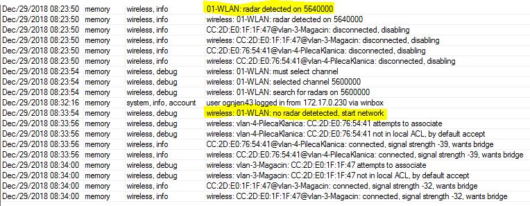

This is matifest after upgrade for 6.43.7 to 6.43.8 and change Frequency mode, country and installation..
My problem is not resolved.
Can I disable radar detection?

@pe1chl Ok, let's say you are right. What now I can to do to resolve this? My AP is set auto freq, my stations is set auto freq. So, what to do in practice to resolve this?
Use a 5Ghz channel that is not in use in your area, one not under DFS restriction.
Re: Radar detected on XXX
Posted: Sat Dec 29, 2018 6:02 pm
by pe1chl
Make a channel list and put those channels in that are not affected by radar.
This requires some manual work, the channel list editor in RouterOS is not very user-friendly, but when you have done it once you
can copy it to other access points via the commandline.
Posted: Sat Dec 29, 2018 11:15 pm
by ognjen
So, I need to set no_country_set and put frequency like 5825..
Stupid rule, stupid law, stupid country..
Ty @pe1chl and @pcunite.
