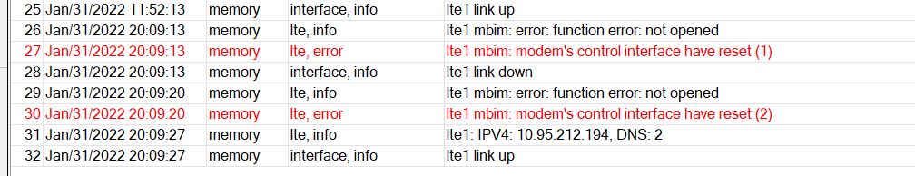

Chateau 5G lte1 interface resets during speed tests or sudden burst of activity
Mon Jan 31, 2022 2:22 pm
Hi everyone,
I've tried searching the forum but I cannot find a thread that talks about my actual issue. I recently got my Chateau 5G and I own the Chateau 12 but I don't experience the same kind of reset on my old device. I am thinking that there might be just an issue with my config or this is a hardware issue (actual Quectel chip onboard). Can anyone give light to this issue please.
What I have done so far:
  • Switched "data_interface" mode from PCIe to USB and vice versa with AT commands // AT+QCFG="data_interface"[,<network>
    ,<diag>]
  • Check modem temp during speed test for possible overheating, temps where normal // AT+QTEMP=?
  • Changed the usbspeed from default 3.0 to 2.0 // AT+QCFG="usbspeed"[,<speed>]
Current firmware: RG502QEAAAR11A06M4G
Router firmware: 7.1.1 and 7.2rc3
emilst

I have exactly the same issue on a LTE12 that I bought few week ago. I have tried same releases as Szxa21 has mentioned, and updated the modem firmware to the last release available I have also opened a ticket on support (SUP-74577), but I don’t have received answer yet. On your side have you few news about this issue?
09:59:57 lte,packet,raw lte1 mbim: wdm >>> recv #0
09:59:57 lte,packet,raw 04000080 10000000 00000000 05000000
09:59:57 lte,info lte1 mbim: error: function error: not opened
09:59:57 lte,error lte1 mbim: modem's control interface have reset (5)
09:59:57 lte,debug lte1 mbim: state 16=>0
09:59:57 interface,info lte1 link down

Same here with 7.10 firmware, device - Mikrotik 5G LMT
lte1 mbim: error: protocol error: not opened
lte1 mbim: modem's control interface have reset (17)
You do not have the required permissions to view the files attached to this post.

Thu Jul 20, 2023 4:58 pm
Any updates here ?
installed tr069-client-7.10.2
still having
lte1 IPv4: xxx , DNS: yyy
lte1 link up

Re: Chateau 5G lte1 interface resets during speed tests or sudden burst of activity
Fri Aug 18, 2023 4:19 pm
new firmware - 7.11 - still the same :(
Fri Aug 25, 2023 1:08 pm
8 reboots in an ±1 hour :(
Fri Sep 15, 2023 9:15 am
i hope this is a needed logging
