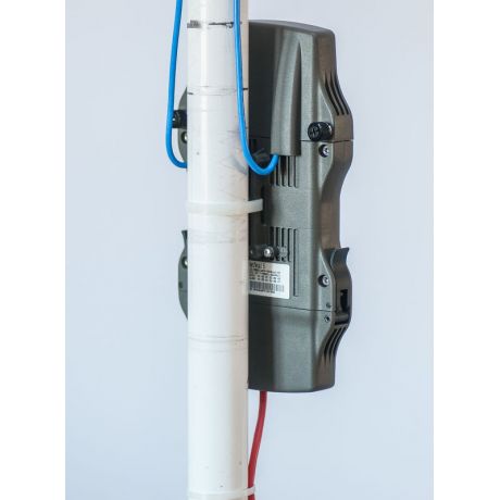

I think that for outdoor use it's recommended to use antennas with (short) jumper cables, which should be pretty flexible ... and use netmetal's cap again. Like this:
(the blue wires on picture are supposed to be antenna jumper cables).
