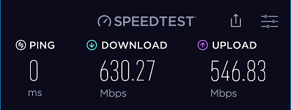

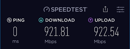

On my Hex Poe , I have enabled Fasttrack. Got some increase but not a huge amount.
I would be interested in seeing the config. I have personally tested Fasttrack vs. non-Fasttrack on RB951G, which has slower and older CPU in it than hEX PoE does, and can confirm I get results very close to what MikroTik boasts on their Fasttrack page (which uses an RB2011, which has exact same CPU in it as 951G does):
Disclaimer: last time I benchmarked Fasttrack, I did it on ROS 6.x. I have not actually re-run these tests on 7.x on the same hardware. Perhaps I should do that...
In any case, this is the result I got when I tested this on the 951G last time.
Without Fasttrack:
With Fasttrack:
Since I got over twice as much throughput on my lab 951G than you did even without Fasttrack on your lab hEX PoE, it makes me think that something else is going on here... (or maybe you are testing with 7.x, and firewall/NAT performance as a whole has gotten worse on 7.x? ...not impossible!)

OK - so now I have some faster nat speeds.
In my prior posts in this topic , I was using a Hex-Poe
I now also have some Hex-S routers.
My head-end network facing these client Mikrotik devices ( Hex-PoE and Hex-S ):
- Adtran TA-5000 ( GPON --- 2.4-Gig to customer and 1.2-Gig from the customer ).
- about 16+ other customers on this shared GPON port facing customers on this GPON port ( single strand fiber ).
Note; GPON uses a single fiber to multiple GPON connected customers.
Note; An ISP may have dozens/hundreds of GPON ports. Each GPON single fiber from the ISP port is then connected to a remote neighborhood located optical-splitter ( think of a switch that does not use any power/electricity ). The optical-splitter then has 8 or 16 or 32 or 64 out ports. Each port from an optical-splitter is then connected to a remote GPON customer. (( Thus - an ISP with a single GPON port can be connected up to 64 remote fiber GPON customers )).
My test remote client router that connects to my ISP via GPON.
- Mikrotik Hex-PoE ( and now also I have a Hex-S ) ROS-Version 7.18.2
** No bridges configured ***
Interface sfp1 ( renamed to WAN ) ( IP DHCP Client ) (( FS sfp module " GPON-ONU-34-20BI " inserted in the sfp port.
Interface ether1 ( renamed to LAN ) ( DHCP server to the customer over this ethernet )
The following fasttrack configurations added to the the client Mikrotik:
/ip firewall filter add chain=forward action=fasttrack-connection connection-state=established,related
/ip firewall filter add chain=forward action=accept connection-state=established,related
My Hex-S can now download and upload at a full 1-Gig ( using remote speed test sites: speedtest.net and fast.com )
My Hex-PoE can now download and upload around 500-Meg+
Notes:
- In my previous posts in this topic , I was ether not using fasttrack - or had it wrongly configured.
- In my previous posts in this topic I was using the following:
- - Bridge WAN with interface sfp1 as a port on the WAN bridge ( WAN was IP dhcp client )
- - Bridge LAN with interface ether1 as a port on the LAN bridge ( LAN was DHCP server )
* All traffic was : GPON-to sfp1 , sfp1 was a port on the WAN bridge. LAN bridge had ether1 as a port on LAN bridge. Customer connected to ether1. (( all IP addresses were on on bridge WAN or bridge LAN -and- all customer traffic was going through the two bridges WAN and LAN )).
In all of my tests , I found that not using any bridges and no ports on any bridge , my speed tests results were always faster.
Also with fasttrack properly configured , everything was much faster.
So , using both fasttrack -and- no bridges are what got my remote Mikrotiks connected via GPON running fast ( Hex-S now hitting 1-Gig up/down ).
Hmmm -- next , I want to try the same test configuration with a remote GPON connected Mikrotik what has a 10-Gig sfp+ port. I suspect I should be able to then hit up to 2.4-Gig down and up to 1.2-Gig up speedtest results.
North Idaho Tom Jones
