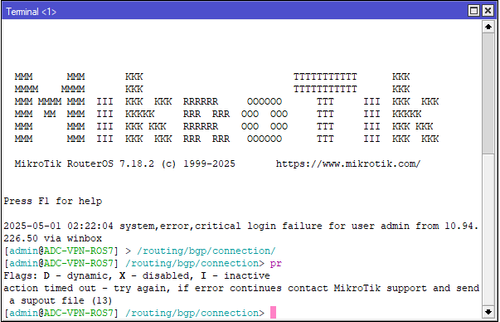

Just had my first BGP routing crash on v7.18.2. Logged into the router because it was still advertising prefixes while the peer was down. The Routing->BGP->Connection tab stayed empty in Winbox even though this router has 10+ BGP connections. Trying /routing/bgp/connection print from terminal resulted in "action timed out". I had to reboot the router before everything was working again.
Created SUP-187763.
