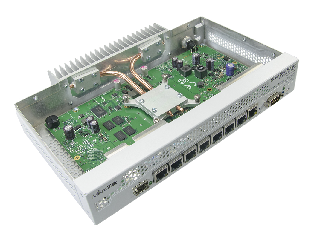

So it seems from the looks of it on the back we see a heatsink. Does that mean that this switch will be fully fanless? Or will it have a fan on the inside?
How deep is it expected to be? About the same footprint as a current CCR?
I think this heatsink looks exactly the same as one in CCR1009-PC so my blind guess is that it's passive because this heatsink internally looks like that:
I think CPU power should be "proportional" considering 10G to 400mhz MIPS in current 1G CSR so maybe this heatsing is used by CPU. However it might be just used for cooling switch chips, hard to tell. However I'm pretty certain it's passively cooled.
