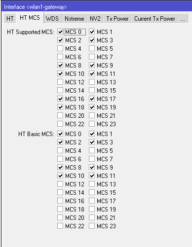

Testing, working good at a/n Ce with configured mcs up to 5 and 13 (75 nad 150mbit), guard interval long, period size 2ms, cell 10km, dynamic downlink ratio 50% Any chance for period size 1,5 or 2,5ms?

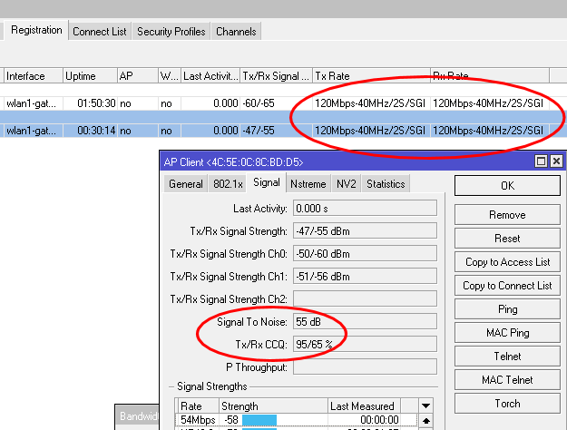

Yesterday we switch from fixed download to dynamic with 6.42rc46 and we have had an improvment from 40 Mb/s to 50 Mb/s with upload working correctly
802.11 a/n/AC
20 Mhz
dinamic downlink
tdma period size auto
client 33
all client signal goog below -50
all modulation good

NV2 is still very bad.
802.11:
nv2 2ms dynamic:

@ hapi Just looking at your clients CCQ and they are terrible ! Are you using default or set data rates?

they are not terrible. They are terrible because the NV2 without the load does not show the correct ccq. The loaded client has CCQ OK. And it's also seen that NV2 goes CCQ down, but the 802.11 holds up.
You do not talk to a beginner.

@ hapi Sorry for this but those very high signals ( -22,......) could be overloading wireless input stages and it appears in this situation that 802.11 is more tolerant than NV2?

Your theory? nonsense. We also have an AP with better signals and even if there is a weaker client and is alone on the AP. Do not worry about things. This is not the only place where the same thing happens. NV2 has always been worse with many clients. Otherwise it behaves with v6.40 in the same place. With the new NV2 it behaves better, but not so good still. And classic nstreme can do better work at this point, but it does not reach UBNT yet.
After a very quick search -please read the following to support my "Theory"
https://community.ubnt.com/t5/airMAX-Wi ... d-p/188574
https://community.ubnt.com/t5/airMAX-Ge ... d-p/197202
Could I suggest as a test as you have issues NV2 (and for our network NV2 is very stable - but getting more throughput is always a challenge)
Have you tried to lower AP power by entering +db number in "Antenna Gain" and try to get client signals in the 50-65 dbm range and test NV2 ?

50-65 dB is low. The world does not know what the conditions are in the Czech Republic. -65dB is almost the level of ambient noise.
I'm not going to solve the RX levels unless you do it yourself. We also have PTP connections with -20dB. You can test + 5dB on your desk and it works fine. The wifi chipset's full-speed readiness is + -75dB. Against -60dB it is only 15dB spacing.
As I said, the results are the same in other locations where signals are around -50dB.

Just done a test on a NetMetal 5 (921UAGS-5SHPacD) with 28 clients associated that runs on v.6.42.1 and latest firmware.
AP radio is on 'only-N', 20/40MHz Ce, NV2 protocol, some fixed MCS rates, Hw. Retries = 3, 75% dynamic downlink mode and tdma 2ms period size.
I have one client with SEXTANT (v6.41.3) and signal Tx/Rx -52/-50 (from AP; Tx =download) that for hours is downloading with its maximum queue (at remote device) which means 10-25Mbps.
If I try to run a MT throughput test (tcp) from another client that has an LHG-'n' (v6.42.1) and Tx/Rx -55/-60 (read in AP) it starts high with over 15Mbps but drops almost immediate back to 3-5Mbps... and stays there...
When I throw the SEXTANT from the AP by its access list the speed of the LHG immediate jumps back to almost 20Mbps! Do I allow the SEXTANT to associate again and after a while the download runs again the speed of the LHG drops back to the previous 3-56Mbps.
Total throughput of the NetMetal during all the time is 20-35Mbps. I can run a bw test from this AP to remote gateway on single tcp stream and get 150Mbps..... So plenty of capacity available.
As I previously confirmed that the 'significant improvement in NV2' claim by MT was true, now it shows it ain't..... One client prevents others from getting higher speed.
(And this is not because some chipset 'don't like the 6.42 software, since this SEXTANT runs 6.41.3..)
Would be nice if any can confirm similar or have any comments...

To 2 clients getting 80mbit 1x1 auto tdma ccq 70 and 85 so i think is`t getting better. Work on latency in overhead situation please.

Just curious why you have set the scan-list=5000-6000 as this results in the AP to listen to all frequencies between 5-6GHz - we when using 20Mhz channels set our AP's -/+ 20Mhz above and below the AP frequency, so for AP freq=5360 scan-list=5340-5480, just to add further we also set hw-retries=5, multicast-helper=disabled, band=5ghz-onlyn,
HT MCS supported and basic have equal setting, we are perhaps over conservative at present on this ! but would rather have a slower more stable connection to the CPE's than data rates varing on very regular basis which customers have complained about?
Conn. rate settings; good mentioning. I only set one, low (6 or 12Mbps) basic rate and then one supported rate that would give me a 'subribers' speed if only one stream connects and then 2 or 3 MCS rates that will give me at least the client's subscribers speeds and 1 or 2 higher. (In 'subscribers speed' I mean that if a client has a 25Mbps contract het at least needs mcs 11 to get it happening, or mcs 5 for the single chain.)

For my experiences the new NV2-Modes "dynamic downlink" are making the PtMP-Links more sensitive in case one of the clients is weak.
After installing 6.40.9 (before 6.36.2) I was wondering about the loss on the weaker link. Ping looks like below (in case there is some MBit traffic on the other better clients of the accesspoint). Accesspoint is a QRT with N-Hardware, not AC-Hardware:
Code: Select all
12 192.168.23.xx 56 64 4ms
13 192.168.23.xx 56 64 33ms
14 192.168.23.xx 56 64 669ms
15 192.168.23.xx 56 64 5ms
16 192.168.23.xx 56 64 4ms
17 192.168.23.xx 56 64 4ms
18 192.168.23.xx timeout
19 192.168.23.xx 56 64 128ms
sent=20 received=19 packet-loss=5% min-rtt=2ms avg-rtt=50ms max-rtt=669ms
After changing the NV2-mode form the default "dynamic downlink" to "fixed downlink" and ratio 50, and setting TDMA period size from 1ms (or auto) to 3ms it was like before with the 6.36.2.
It saves trouble not to have weak links (mine hast SNR: 45, compared to >55dB on the other clients), but sometimes you do not have an option ;-).
Other useful setting for this scenario (of some weak clients) are:
- set data rate to "configured"
- reduce the connect rate to e.g. 120Mbps by disabling "HT supported MCS" MCS4-MCS7, MCS12-MCS15, MCS16-MCS19, all other must be enabled
With this settings the clients will connect with 120MBps or lower and never higher, resulting in >90% CCQ and lower packet jitter
Here you see: only connect-rates up to 120MBps and good CCQ>90, (however at least for the downlink (TX)).
Just my thoughs,
Leo.
n21roadie
Forum Guru
Forum Guru
Posts: 1949
Joined: Fri Aug 07, 2009 10:36 pm
Location: Limerick,Ireland
Re: Significant improvement for wireless Nv2 PtMP
Wed Nov 14, 2018 8:47 pm
@leonix - Not sure why HT supported MCS rates 16-19 are enabled when they require 3 spatial streams and QRT is dual chain?
