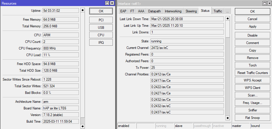

by JohnTRIVOLTA
Because there is a LTE modem on board can achieve 25dBm with Australia or Superchannel selected?

by mkx
Presence of LTE modem has nothing to do with WiFi Tx power.
But I'll be damned: I went to check reg-info for Australia on different wifi devices, all running ROS 7.18.2. As I already mentioned, on Audience regulatory limit is set at 20dBm. But when checking on wAP ax I was mighty surprised, there reg-info says the limit is at 36dBm. On RB951G (running legacy wireless driver) limit is 36dBm as well. On hAP ac2 (without any wifi driver, it's used as main router and CAPsMAN) the limit is 20dBm.
I also checked a few older devices, which are running ROS 6.49.18: hAP has limit at 36dBm, hAP ac lite as well.
So I've no idea about why a few devices have much lower country limit for Tx power for Australia. I'd say it's because of wifi-qcom-ac driver but my hAP ac2 doesn't run any wifi driver.
