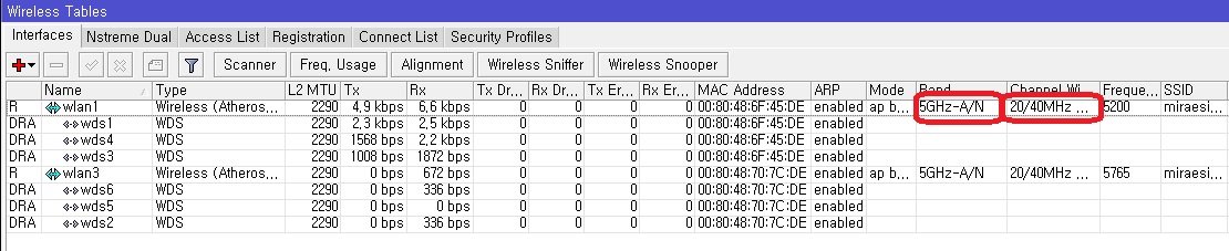

below capture, you can see 20/40MHz as I set.

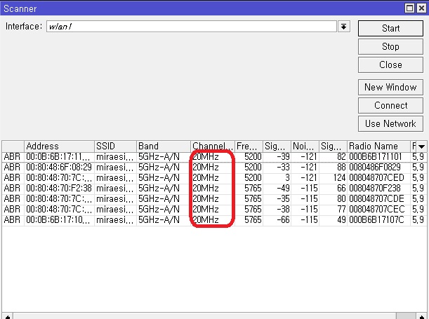

But below capture, scanned result is only 20MHz.
Throughput test is only around 20Mbps. I wish more then 200Mbps at indoor.

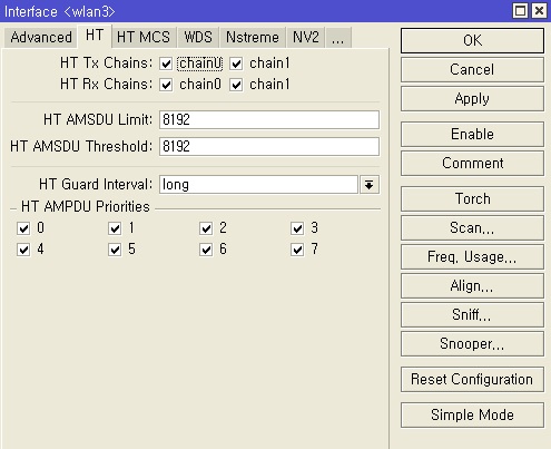

Lower Tx Power (u should have around -45 to -55dBm)
Then set AP and Client:
HT Guard Interval to long
HT Extension Channel to Above Control
Select all 7 Options under HT AMPDU Priorities
What it mean " HT Extension Channel to Above Control"
I don’t know how it control
Should look like this. ROS V5

Thank you for your answer. but I cannot find HT extension channel.
Is it difference of version?
I’m v5.9

you already set ‘HT extension channel above’ with ‘20/40 MHz above’ in channel size. that option moved in Ros 5.
I would suggest using mpls ptp wireless link guide on wiki if you don’t want to use wds.
