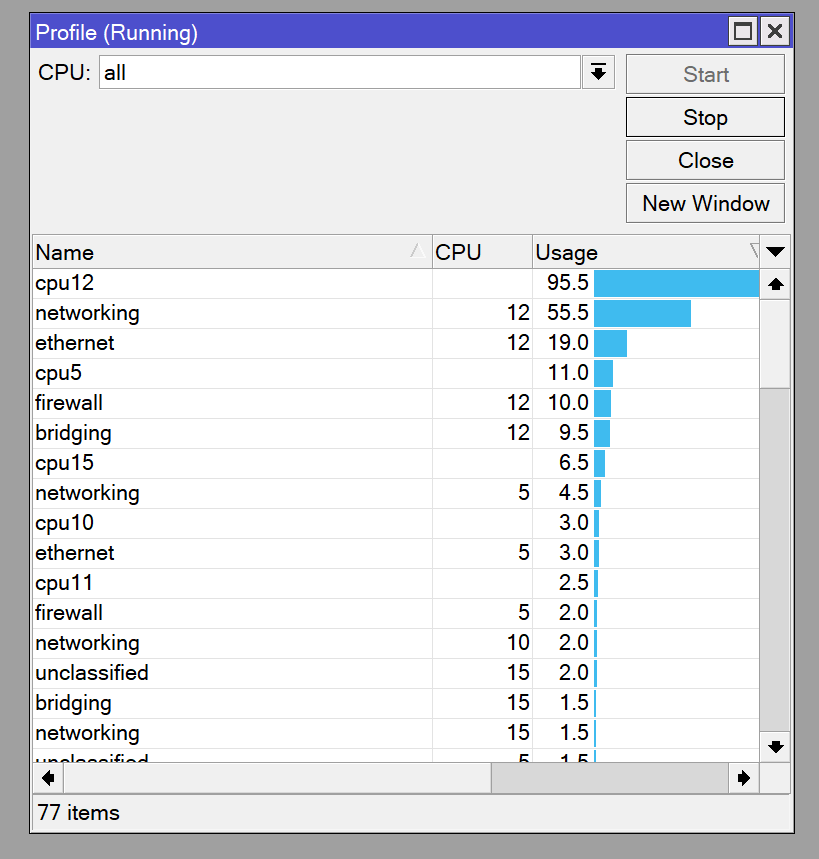

CCR2116 disappointing can't do >2gbps PPPOE, single CPU >95%
Hi, due to PPPOE being single threaded CCR2116 can’t do more than >2gbps as PPPOE client, is there a way to make this process multi threaded or hardware offloaded?

I have no problem with > 2Gbps and pppoe-client as WAN on a much weaker RB5009. The RB5009 CPU only clocks up to 1400MHz, while the CCR2116 can do 2000MHz so while PPPoE might be single threaded, the CCR2116 should have no problem.
Here I am testing with a test server from my ISP, but located in a city 2000km away. That server uses IPv6, no fasttrack in use:
As you can see, the RX rate on pppoe-out1 reached 2.2Gbps. Here another screenshot of the CPU load and frequency @ 2.2Gbps
