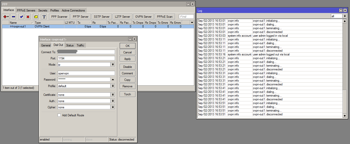

Some info about my system.
Mikrotik ovpn_client:
LAN addresses
192.168.88.0/24
OVPN address:
172.19.18.14
/interface ovpn-client print
0 R name=“ovpn-out1” mac-address=xyz max-mtu=1500
connect-to=serverIP port=1194 mode=ip user=client
password=“” profile=default-encryption certificate=cert1 auth=sha1
cipher=aes256 add-default-route=no
