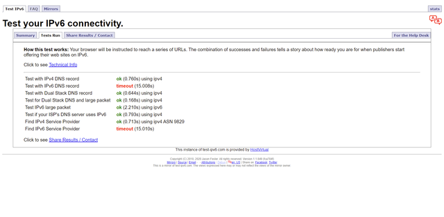

My devices do get IPv6 addresses and they can reach some IPv6 sites but fails IPv6 tests (IPv6 large packet fail) and they cannot be pinged from the outside. Sometimes IPv6 stops working completely until I reconnect my client devices from scratch.
This probably means that your internet connection does not have MTU 1500 but a smaller value.
Check what the MTU value is and if you can raise that to 1500. E.g. when you use PPPoE there is a Max MTU and Max MRU field in the settings, put 1500 there and see if it works and this larger MTU is accepted (this requires that your ISP support RFC4638).
When it works, your problem is probably solved. When it is not working and you are still stuck with something like MTU 1480 or 1492, see what it is and copy this value to IPv6->ND (open the “all” line and enter the MTU there).
Now restart your clients and see if it now works.

IPv6 large packet fail means the receiver was unable to deliver ICMPv6 Type 2 (Packet too big) to the sender. The whole point of ICMPv6 Type 2 is to negotiate IPv6 packet size as IPv6 standard mandates, IPv6 cannot be fragmented.
Cloudflare has a blog about IPv6 “fragmentation”: https://blog.cloudflare.com/ip-fragmentation-is-broken/
I’ve used the standard minimum IPv6 MTU 1280 in IPv6>ND to avoid MTU related issues.
And fixed MTU for IPv4 in the PPPoE interface that’s determined by my ISP at 1460.

Yes, I’ve done this and was able to reproduce the same issue. And yes, at the moment, IPv6 firewall is the default from the RouterOS script on first boot.
So I tried settings it up again and noticed something, only 3 client devices at any given point of time are getting IPv6. Any ideas what could be causing this?
Here are my results on a Windows 10 Machine (I had to create a new inbound rule in Windows firewall to allow ICMPv6 echo and packet too big to get these results):
