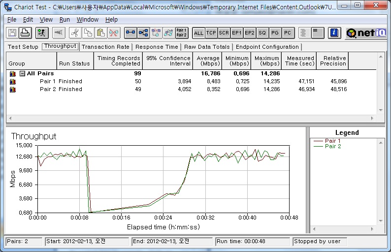

I’m testing 433GL X 3 unit with mesh mode.
HT 20/40 above, Chain0/1, HT Guard interval long, Dynamic MESH
(there is no noise 5GHz)
Problem in mesh mode is
  1. throughput is just up to 24Mbps.

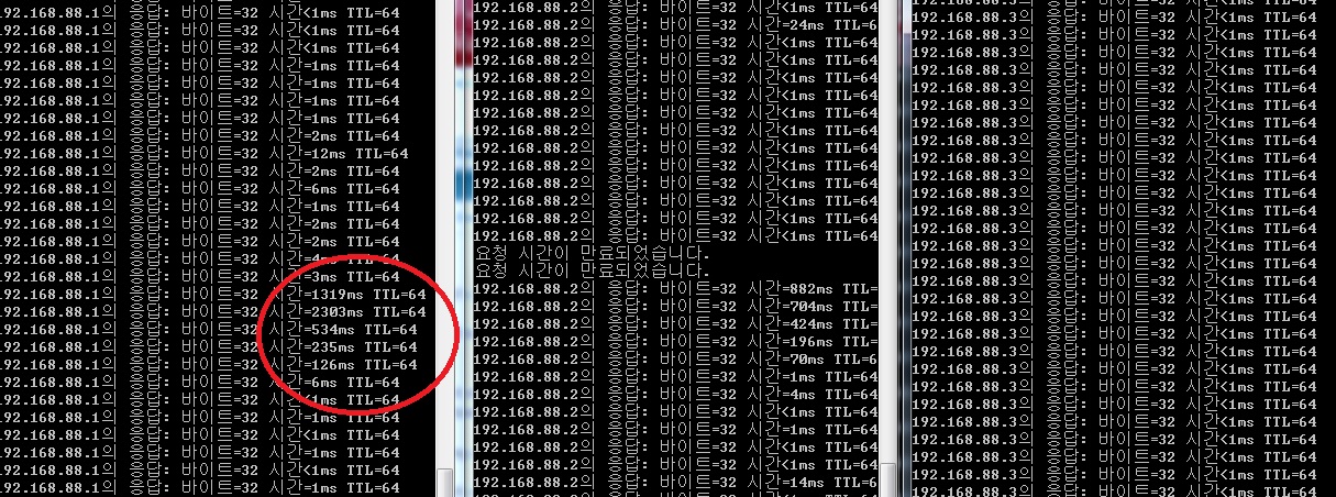

  2. When one of them is disconnected, throughput is very low, so even cannot send small size video.
    And ping reply time is over 1000~2000ms 3~5seconds.
    So I wish to know how to set for
  • maximize throughput in mesh mode(expecting 60~100Mbps)
  • minimze mesh recovery time and delay time.
please help me anybody
