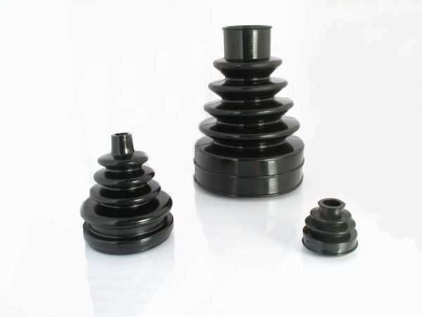

If you still insist on doing that, you should IMHO:
  1. use some good auto-bonding tape around the connectors
  2. put a thin layer of vaseline grease (yes really) on the tape
  3. cover the whole stuff with a grommet/gasket like these:
    https://barbierirubber.it/prodotto/soffietti-conici/

You put the grommet on the antenna and you fold It upside down (or in/out).
You put a thin layer of vaseline grease on the exterior (thread) of the connector.
You screw in the antenna over the connector.
You apply normally the self-sealing tape around the connection, wrapping It from the base upwards.
Then you put a thin layer of vaseline grease over the tape.
Then you reverse the grommet, thus covering the connector and tape.
If the grommet Is tight enough on the stem on the antenna that’it, though putting a nylon tie around the collar on the top won’t do any harm.
Is this what you mean by grommet?
Yep. :slight_smile:
