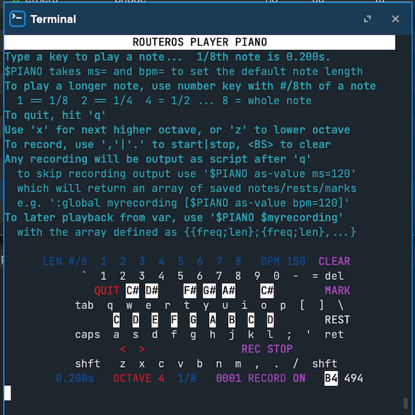

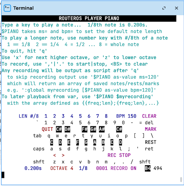

    # help screen
    :put "\1B[1;7m                    ROUTEROS PLAYER PIANO                    \1B[0m"
    :put "\1B[1;36mType a key to play a note...  1/8th note is $[:pick $nms 7 16]s."
    :put "\1B[2;36m\$PIANO takes ms= and bpm= to set the default note length"
    :put "\1B[1;36mTo play a longer note, use number key with #/8th of a note"
    :put "\1B[2;36m  1 == 1/8  2 == 1/4  4 = 1/2 ... 8 = whole note"
    :put "\1B[1;36mTo quit, hit 'q'"
    :put "\1B[1;36mUse 'x' for next higher octave, or 'z' to lower octave"
    :put "\1B[1;36mTo record, use ','|'.' to start|stop, <BS> to clear"
    :put "\1B[1;36mAny recording will be output as script after 'q'"
    :put "\1B[2;36m  to skip recording output use '\$PIANO as-value ms=120'"
    :put "\1B[2;36m  which will return an array of saved notes/rests/marks"
    :put "\1B[2;36m  e.g. ':global myrecording [\$PIANO as-value bpm=120]'"
    :put "\1B[1;36mTo later playback from var, use '\$PIANO \$myrecording'"
    :put "\1B[2;36m  with the array defined as {{freq;len};{freq;len},...}"
    :put "\1B[0m"
    :put "      \1B[2;34mLEN \1B[1;34m#\1B[2;34m/8\1B[0m \1B[1;34m 1\1B[0m \1B[1;34m 2\1B[0m \1B[1;34m 3\1B[0m \1B[1;34m 4\1B[0m \1B[1;34m 5\1B[0m \1B[1;34m 6\1B[0m \1B[1;34m 7\1B[0m \1B[1;34m 8\1B[0m   \1B[2;34mBPM \1B[1;34m$lbpm  \1B[1;35mCLEAR\1B[0m"
    :put "\t\1B[0m    `  1  2  3  4  5  6  7  8  9  0  -  = del"
    :put "\t      \1B[1;31mQUIT\1B[0m \1B[1;7mC#\1B[0m \1B[1;7mD#\1B[0m    \1B[1;7mF#\1B[0m \1B[1;7mG#\1B[0m \1B[1;7mA#\1B[0m    \1B[1;7mC#\1B[0m        \1B[1;35mMARK\1B[0m"
    :put "\t\1B[0m   tab  q  w  e  r  t  y  u  i  o  p  [  ]  \\"
    :put "\t         \1B[1;7mC\1B[0m  \1B[1;7mD\1B[0m  \1B[1;7mE\1B[0m  \1B[1;7mF\1B[0m  \1B[1;7mG\1B[0m  \1B[1;7mA\1B[0m  \1B[1;7mB\1B[0m  \1B[1;7mC\1B[0m  \1B[1;7mD\1B[0m        \1B[1mREST\1B[0m"
    :put "\t\1B[0m   caps  a  s  d  f  g  h  j  k  l  ;  '  ret"
    :put "\t\1B[1;31m          <  >               \1B[1;35mREC\1B[0m \1B[1;35mSTOP\1B[0m"
    :put "\t\1B[0m   shft   z  x  c  v  b  n  m  ,  .  /  shft"
    :put ""

Code could be cleaned up, but it does use quite a few tricks. The central one is using /terminal/inkey – but that is the basis for any interactive UI in RouterOS scripting. A more simple example of using /terminal/inkey is here: http://forum.mikrotik.com/t/how-to-add-color-to-output/142687/1

Recording feature is amazing! Bravo sir!
I have only one note - you should correct octive to octave :smiley:
LOL. My spelling was in a higher octave of vowels. Thanks, fixed octAve spelling in script/text.
Also added support for the left and right arrow keys to change octAve & also now check octAve they are between 1 and 9. Plus, note sizes are “reduced” 1/8 … 1/4 … 1/2 … 1 (not 2/8 … 4/8 … 8/8 )
$PIANO - interactive “player piano” & studio-quality recorder using :beep

FWIW, even with all the ANSI codes… $PIANO, surprising, renders perfectly in WinBox4 beta & new fonts really look nice. Both Dark Mode and Light Mode.

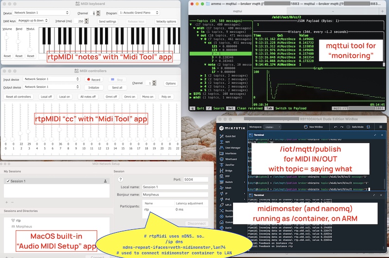

There is always midimonster, which can translate/map MIDI into a bunch of protocols and scripts… The only overlap is MQTT, since both RouterOS and midimonster support it.
I have a Behringer XTouch, so ended familar with midimonster. And have MQTT setup for some other testing. So I can confirm you it’s MIDI IN/OUT is possible, granted some MIDI thing, midimonster, MQTT broker, iot.npk are all required… But you ain’t replacing a keyboard or mixer with :beep anytime soon. But here is the quick midi monster.cfg I used in a quick test for any adventeous souls:
[backend rtpmidi]

[mqtt mqtt1]
host = mqtt://MQTT_BROKER_IP:1883
/midi/mqtt/in/{0..15}/note/{0..127} = range 0 127
/midi/mqtt/in/{0..15}/cc/{0..127} = range 0 127
[map]
rtp.ch{0..15}.cc{0..127} > mqtt1./midi/out/{0..15}/cc/{0..127}
rtp.ch{0..15}.note{0..127} > mqtt1./midi/out/{0..15}/note/{0..127}
mqtt1./midi/mqtt/in/{0..15}/note/{0..127} > rtp.ch{0..15}.note{0..127}
mqtt1./midi/mqtt/in/{0..15}/cc/{0..127} > rtp.ch{0..15}.cc{0..127}
(and you need an MQTT broker like mosquito running with it’s IP replacing “MQTT_BROKER” above, and the /iot/mqtt/broker set to same IP/port).
But wiring it to $PIANO … IDK. /queue max values wire to a faders with MIDI CC might be fun. Or /tool/netwatch “playing” sharp intransient notes via MQTT (to MIDI via midi monster) in on-down= or perhaps on-test= using latency/%loss to change pitch/etc for some flair.

Now I´m even more amazed, that it´s actually somehow possible to hack a MIDi Keyboard to drive a speaker over MQTT on an MT switch!
Thanks @Amm0 !
Nope. More inspirational. And, I forgot to mention, https://mountainutilities.eu/miditools – since not everyone may have MIDI devices/interfaces – but Midi Tools app can use rtpMIDI. So it is possible…
Since I really did have the MQTT and /container parts all setup from a different project… So I took a screenshot of what a prototype RouterOS DAW would look like. Ironically, the window arranging and annotations took longer than the setup. But turned out to be quite a “mix tape” of RouterOS features*…
It does work to pass MIDI IN/OUT… but using it for something useful – now that some take real creativity.

Just to cover the all the “audio interfaces” of RouterOS, there is also audio input via HTTP available:
curl -u $USER:$PASSWORD 'http://$ROUTERIP:80/rest/beep' --json '{ "frequency": "2000", "length": "1s" }'
with a “low latency :beep” interface provide via https://help.mikrotik.com/docs/display/ROS/API (where you can keep TCP session alive to pipeline next notes)
So anyone can play along from home too…
I did publish my “make.d” test container used here on GitHub, which includes midimonster:
https://hub.docker.com/r/ammo74/make.d
(from https://github.com/tikoci/make.d).
It does more than midimonster… but to use it for rtpMIDI (via midimonster)… you install it like a regular container, then set the cmd=“midimonster mqtt” which will start an MQTT broker, and the midimonster. Using /container/shell [find tag~“make”] will get you to the container’s terminal, which you can edit the midimonster config file with particular mappings.
What’s actually interesting about midimonster is that you can really map anything-to-anything (at least of the backends it supports). So you actually use link MQTT topics to Lua* or Python code, without any MIDI being involved too. Or TouchOSC, would allow some “remote control” apps too. And there is also lightning, since midimonster also supports DMX too.
