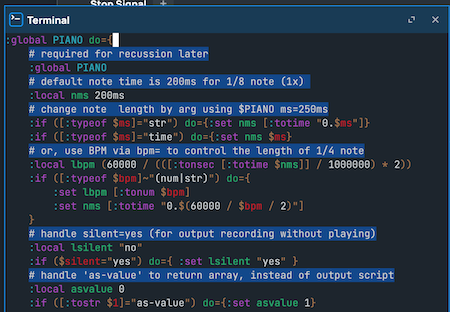

Take my $PIANO script, if the script is “correct”, you’ll see all the colors indicating types
Even a light red shows [undeclared] args, which is correct here, but using function args is rare, and undecleared variables are normally bad… why $bpm, $silient, etc are red - but still parses so you see colors everywhere).

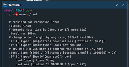

But throw a bad command into the mix, all colors gone means it cannot be parsed. And if edit cannot colorize it, the script engine would be able run it either:
Now having it all colored does not mean it will “just work”, but at least it won’t be a syntax error that’s the issue.
