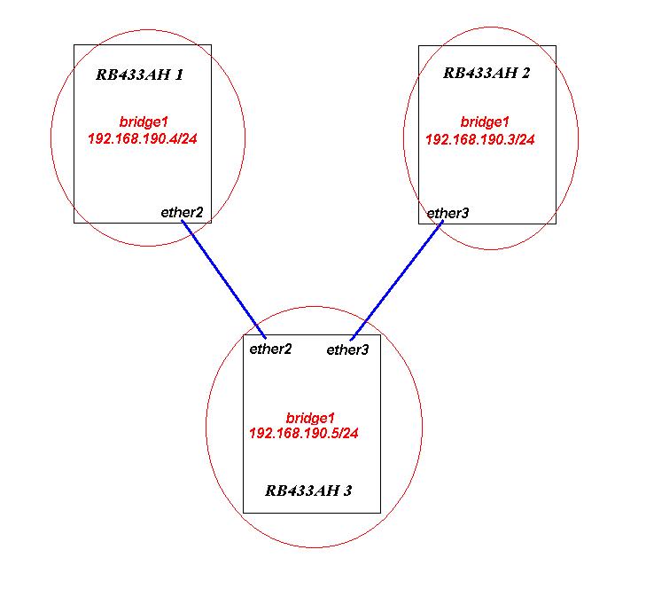

Hello people, I have the same problem. I have three RB433AH (RB1 RB2 and Rb3), and the RB2 and Rb3 are connected on ports ether2 and ether3 of RB1, and is exactly the same problem that nolis said. We need a fast reply for this issue, Mikrotik team. Regards,

In my case are three RB433AH, RB1 and RB2 connected in RB3. The RB1 and RB2 simply stop responding after a few hours. If you need more information please ask. We need to resolve this.
Is ether1 is used to connect to RB3 or any other port?
This is connected as the image attached. All ethernet ports are on bridge1. When the problem happens, I tried to swap the ethernet ports but not resolved. I tried to disable auto-negotiation but not resolved.
