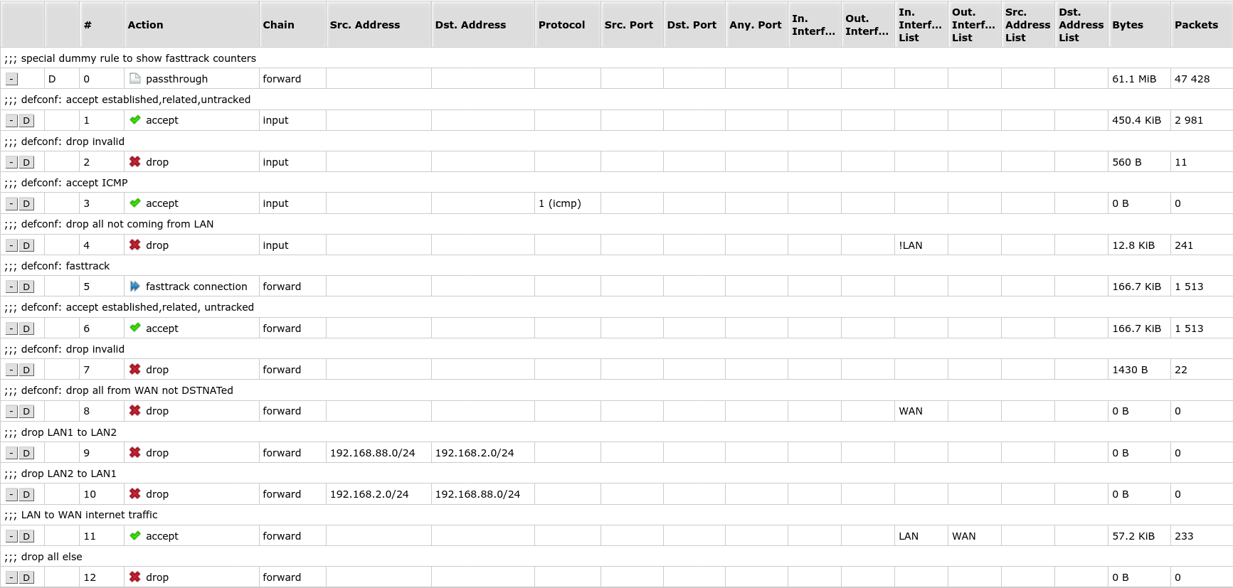

I think I understand enough now. Below is a pic of the way I set up my rules. Everything seems to be working fine so as long as no one sees anything wrong with it I think I’m good.
Thank you all very much for your help. Very much appreciated. Now on to my less important but more interesting questions :slight_smile:

Your firewall rules look roughly good. I would really suggest the allow-what-I-want-and-drop-everything-else mindset. It’s much easier to do correctly and later maintain it.
