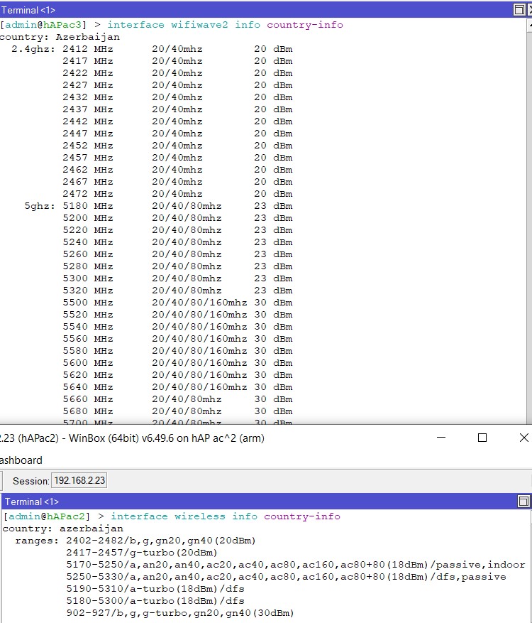

This is for the “MT wifi classic drivers”. Country Lock? Who did this ???
Wifiwave2 can be different. Didn’t test this yet.
However I know that wifiwave2 tends to allow 3 more dBm because of TPC handling.
While checking there is a hughe difference in allowed EIRP between classic wifi in 6.49.6 and wifiwave2 in ROS 7.5beta8, for region Azerbaijan.
Could not test classic on hAPac3 now, because classic<->wifiwave2 switch requires install/remove of the wifiwave2 package AFAIK. Inconvenient right now.
But should be the same for hAPac2 and hAPac3, or did it change with the ROS version?
The wifiwave2 EIRP limits are as good as those for the rest of Europe. The classic ones here are lower (18dBm)
