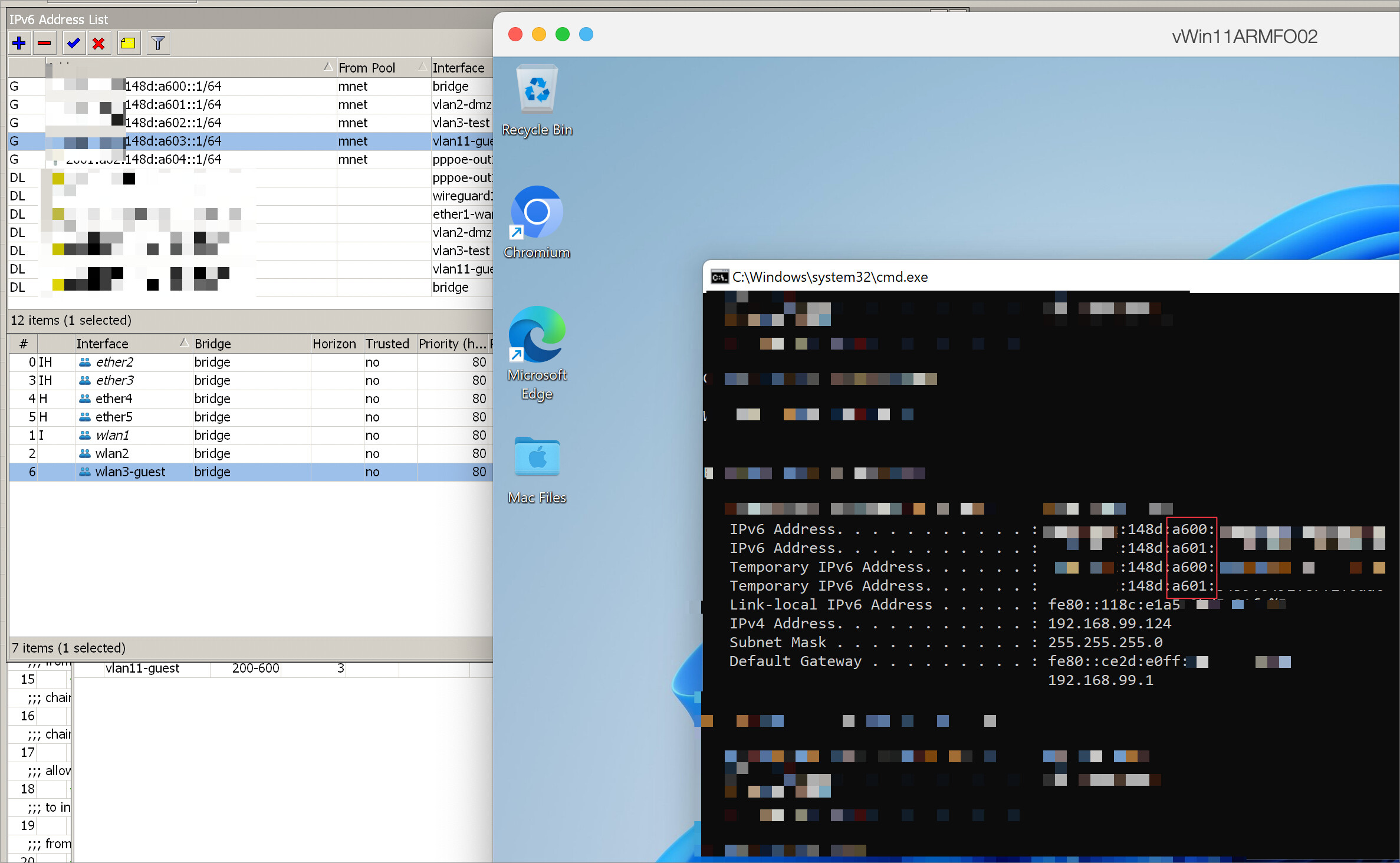

On my macbook connected via WLAN i have a windows VM running which gets IPv6 addresses from a few, sometimes all vlan interfaces with advertising turned on.
This happens on every reboot. If I disable IPv6 on the Windows NIC and re-enable it, I “only” get the IPv6 address as expected.
After a reboot I have at least two IPv6 addresses from at least two different vlans and this is also random on every reboot.
The virtual NIC of the VM is bridged on macOS via the Hypervisor Parallels…
How is this possible?

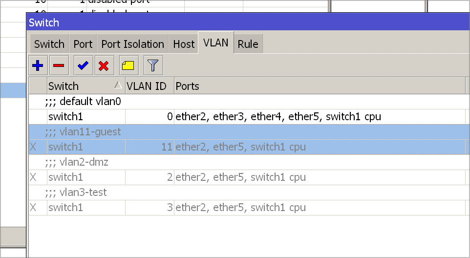

The still persists, even when I disable the particular VLANs on the switch:

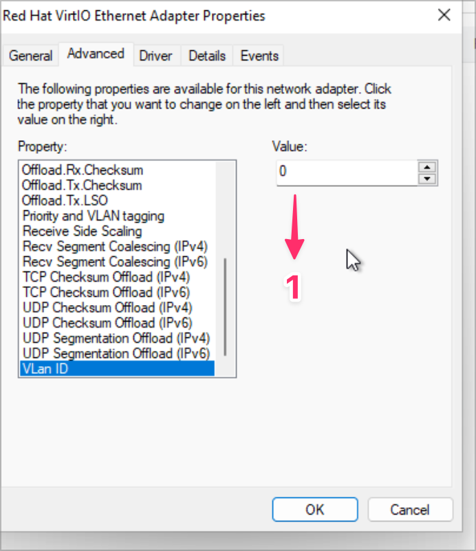

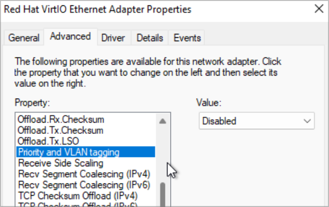

Most Windows network card drivers silently strip any VLAN tags from received frames, rather than ignoring VLAN-tagged ones.
Hm. How is it possible that this is going over WiFi?
IIRC WLAN tags aren’t sent over WiFi, right? But my Win-VM running on the mac (connected via WiFI) inside Parallels Hypervisor receives RAs so there must be some leak…

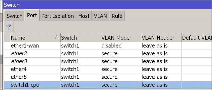

There is a manual https://help.mikrotik.com/docs/display/ROS/Switch+Chip+Features#SwitchChipFeatures-PortSwitching
maybe it could put some light on the problem:
Switch chips with a VLAN table support (QCA8337, > Atheros8327> , Atheros8316, Atheros8227 and Atheros7240) can override the port isolation configuration when enabling a VLAN lookup on the switch port (the vlan-mode is set to fallback, check or secure). If additional port isolation is needed between ports on the same VLAN, a switch rule with a new-dst-ports property can be implemented. Other devices without switch rule support cannot overcome this limitation.

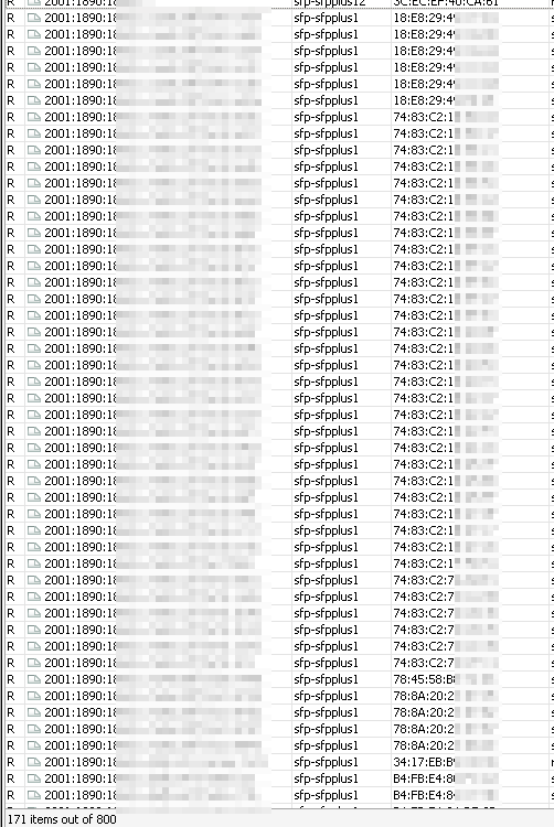

Beating a dead horse, but thought all would find this interesting. Check out all this misbehaving Ubiquiti Unifi AP’s.
I’m still seeing this issue in various deployments.
Searching the net shows lots of people have similar issues only related to IPv6 RAs and it looks like only WindowscClients are affected…

In my case a Windows Client is connected to a port with PVID 1 which also has some tagged vlans on it.
The Windows Client is running inside a VM. It’s not possible to remove the VLAN tags off of the port because they’re required for other VMs on the VM-Switch.
My hypervisor is Proxmox and I’m using virtio vNIC (https://bugzilla.redhat.com/show_bug.cgi?id=1854416).
There seem two workarounds:
Option #1:
Set “Priority and VLAN tagging” in the driver to disabled
Option #2:
Set VLAN ID to the untagged PVID of the port the machine is connected to.
In my case PVID is 1 so I set the NIC driver to vlan 1 (is set to zero by default):
