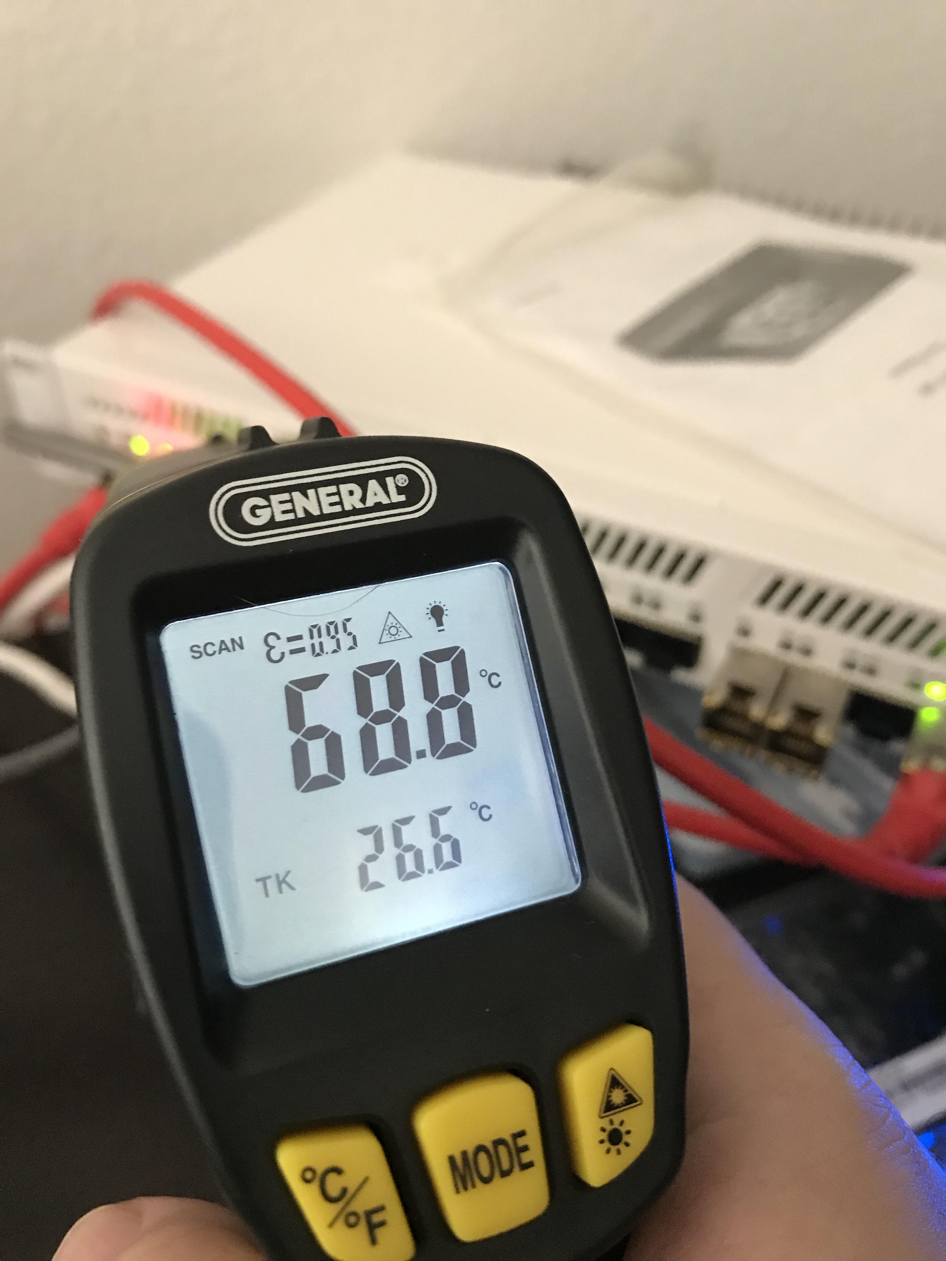

Seems to be about 70 C. Methodology to measure was quite simple. I used less reflective than SFP module cases screwdriver bit and put it on three SFP+ modules. And when it got hot (in a few minutes), measured temperature with laser thermometer. This methodology is not ideal and real temperature could be even higher.

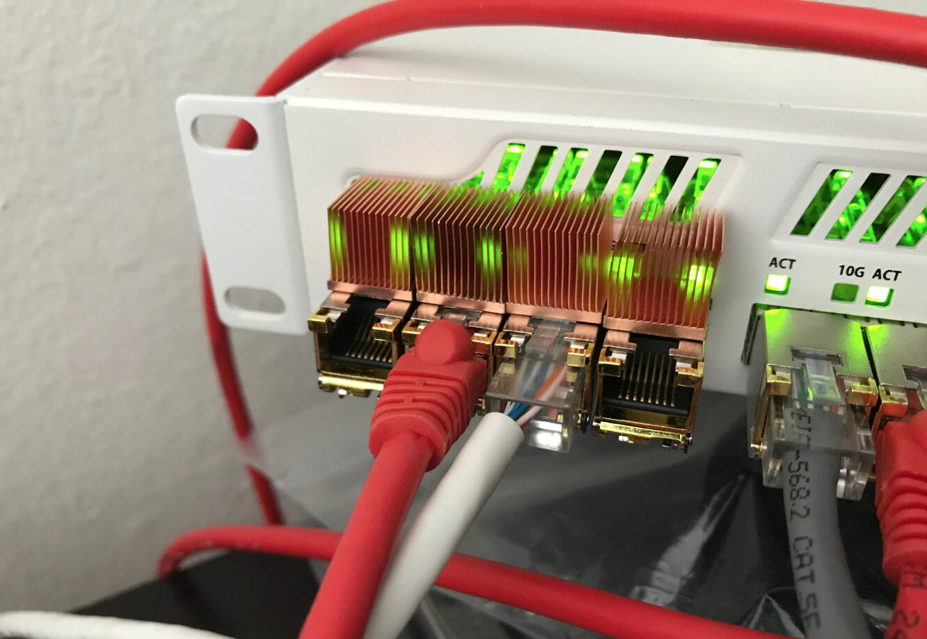

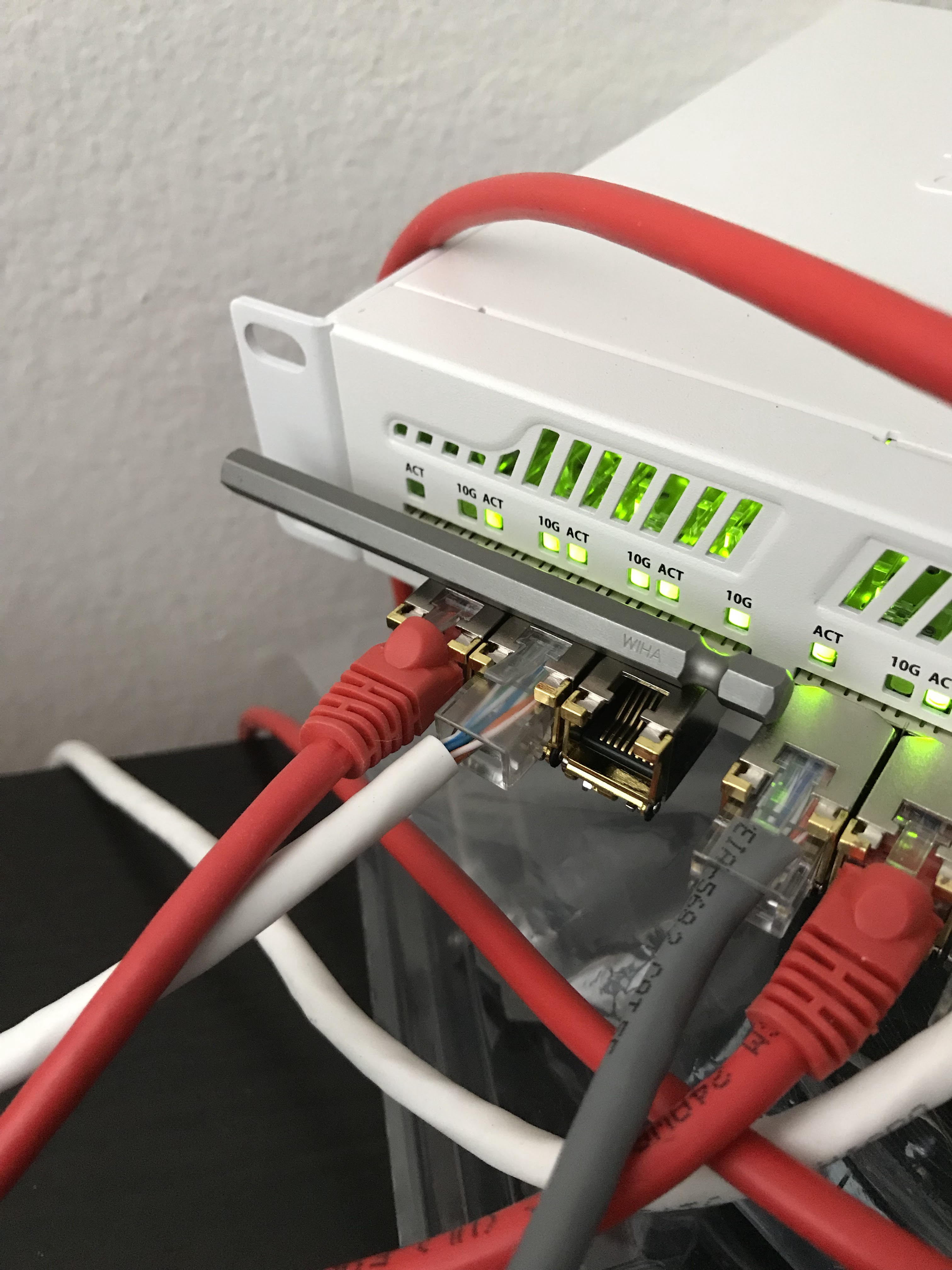

Here is my workaround solution. Temperature now managed around 50C degrees.

Here is the temps for S+RJ10 in CRS210 and CRS328. Does not get that hot in CRS328. Also not too hot in CRS210 if no connection.

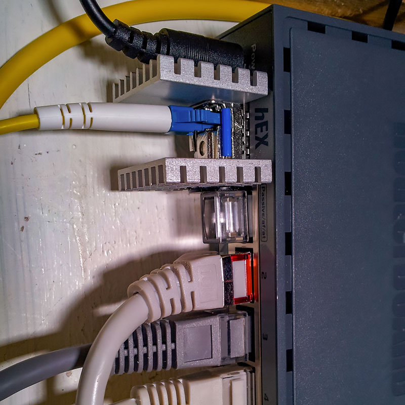

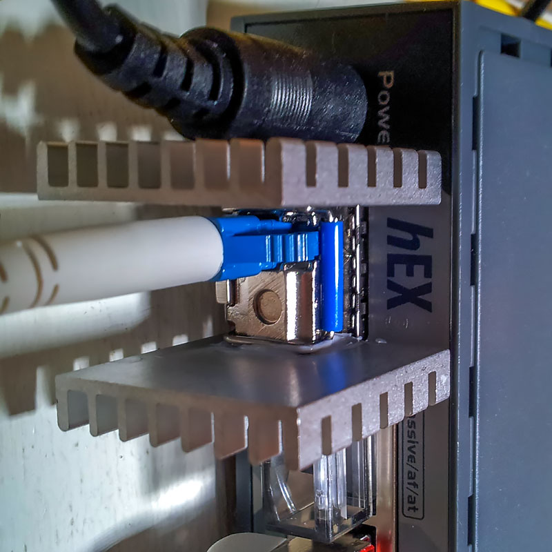

I made pictures of the new temporary setup with real heat sinks. The top one is pushed between the powerplug and the SFP and the lower one rests on a dummy RF45 and to press the heat sink up there is a washer between them. Because there is not a perfect fit for the lower one I have applied some thermal-paste. In the final version I will glue the heat sinks to the SFP.
The measurements of the heat-sinks are 2,5cmx2,5cm and the thickness is 5mm. To give the power plug more room you can file in the middle some material away.
Update: I have installed a small 5cm fan to blow over the top heat sink and the top of the hEX S and the temp of the SFP is now stable at 39 degrees and that is also the temp from the hEX S and which is 3 degrees lower than before. The moving air is also drawing warm air through the top holes of the hEX S
Update 2: the fan is so efficient that the temperature of the FSP is below the temperature in the box .
