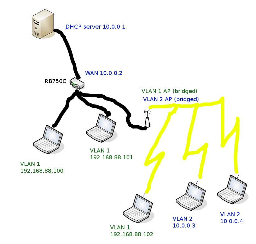

Is it possible to NAT & bridge on the same Ethernet (WAN) interface by using different VLAN’s?

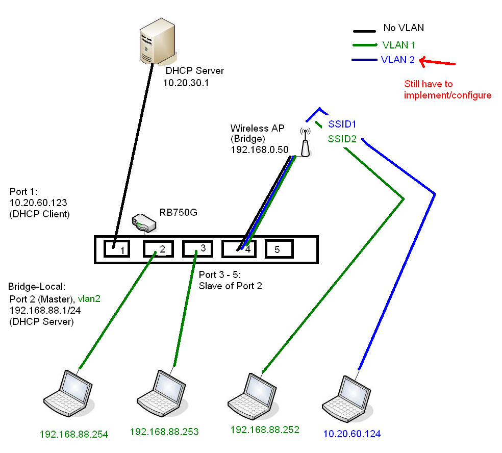

See the attached image for my network setup that I want.
I currently have VLAN 1 bridged with my local Ethernet ports (in a NAT configuration) on my RB750G with RouterOS 4.3. How would I go about to let VLAN 2 be bridged with my Ethernet (WAN) interface such that all the devices on VLAN 2 would automatically get unique WAN IP addresses from a DHCP server (that I don’t own/manage) on the WAN connection. The WAN connection shouldn’t have any VLAN tags.
please, show different VLANs with different lines, I don’t unterstand your picture %)
p.s. different interfaces too
Chupaka, thank you for your attempt/interest.
Here’s a more accurate/current diagram of my network configuration - see attachment.

I’ve eventually managed to get it working like I wanted:
It was actually very very simple:
  • Created VLAN1 & VLAN2 on the Ether4 (connected to the WiFi AP)
  • Created a bridge-WAN (with DHCP client enabled): Ether1 & VLAN1
  • Created a bridge-local (with DHCP server enabled): Ether2, Ether3, Ether5 & VLAN2
The differences between the previous sketch of my network setup and the one I have now are:
  • Removed Slave settings from Ether2-5
  • Placed Ether3&5 in Local bridge
  • Created a bridge-WAN: Ether1 & VLAN1
I’m not sure exactly where my mistakes were, but the biggest one was definitely that I had my Ether4 (connected the WiFi AP) set as a Slave of Ether2.

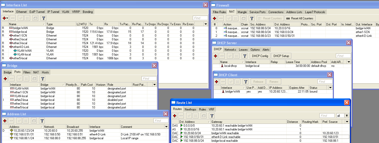

I’ve attached a screenshot (quick overview) of how my setup looks in WinBox:
