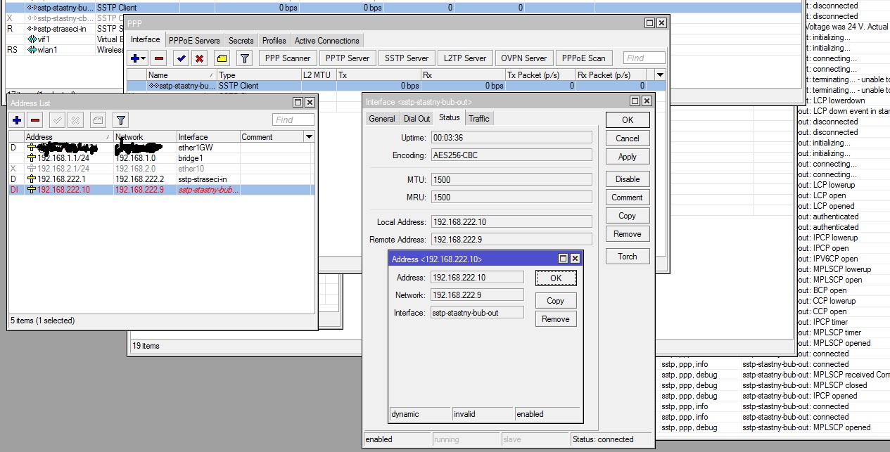

When I updated the RB2011 which serves amongst others like SSTP server and also SSTP client for another connections I realised that those SSTP connections that was dialed from this device with newly installed 6.19 do not work while received SSTP calls from other 6.18 devices are still on. I fiddled around and saw that on server side (6.18) everything looks good, connected and without any problems. Client side (6.19) has also connected status, everything fine, just missing “R” mark. What is more, the keep-alive packets are going forth and back. But none traffic, none pings, nothing. After that I saw that IP address added on client side is marked as invalid:
Why the address is invalid suddenly in 6.19 if it was valid in 6.18?

6.19 shows that the address is invalid because the interface is not active.
Once the link comes up, the address will be valid again.
Where you see the reason? The tunnel is up. Server side shows “R” status and clients side shows connected. So what to do?
Your interface shows that it is down.
Something is not working.
The address will not be valid until the interface is functioning.
see attached… Interface up, Address up.

Notice that your interface status is “Connected” and not “Running”

I noticed that. But this config works in combination (server-client) 6.18-6.18 and 6.19-6.18 but not for 6.18-6.19. Why just installing 6.19 on client side breakes it? If it is connected and both sides are reporting in debug log that sending and receiving control packet echo request and echo response, how to understand it?
How is it possible that server side on 6.18 reports running status while client on 6.19 reports only connected but not running?
