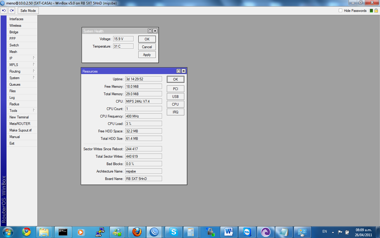

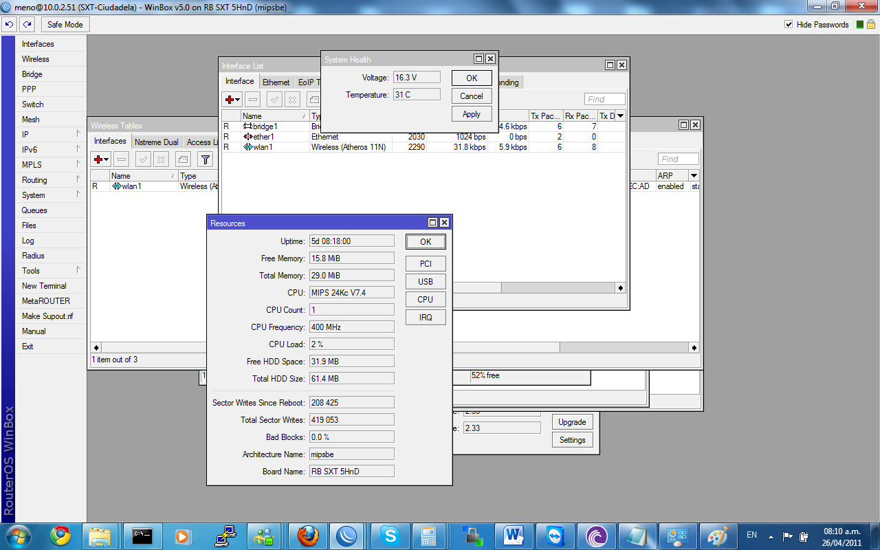

I have 2xSXT, one powered by 15v and one 24v and they shows 10.4v and 17.2v. Also temp is wrong 25 and 28. RouterOS 5.1.

why it could be different, see mine.
