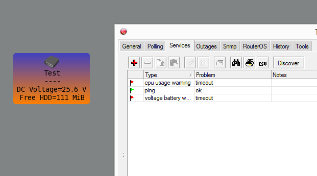

Can u reproduce this problem
As u can see on the picture (in label appearance) Dude can read two functions but probe says “time out”
After rebooting Mikrotik Device - where Dude is installed all back to normal for some time
Edit. I inspected the problem, I come to this findings
For some reason Dude stop reading values from device, as u can see on picture values are wrong they are “stuck” at the point where dude probably lost connection to the device but for some reason Dude cant reprobe or cant get new values from the Device
But when I try dabble click on device in RouterOS TAB - Interfaces I can see interfaces as it should be (on ether1 bits are rolling every second as traffic passing by)
That mean Dude have access to the device
After Rebooting Dude server Functions- start reading again and Probes go up again.
Another thing on Device label as u can see two from tree probes are down Device have orange colour as normal but there is no info about 2 probes on label [Device.ServicesDown]
Function are made using ros_command for example “ros_command(”:put [/system resource get cpu-load]“)” and etc. etc.
