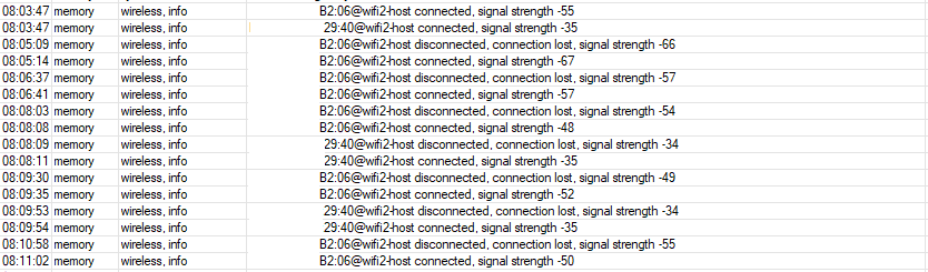

I have recently updated my hAP ax2 to RouterOS 7.9. However, I am experiencing issues with wireless client which are unable to connect and obtain IP address from DHCP - wired clients work. I have NOT changed anything in my configuration and when running ROS 7.8 wireless clients have no issues and everything works well. In image (Log screenshot) there are two devices experiencing the same problem - vacuum robot and home camera (stationary devices) are unable to connect to WiFi. Complete configuration in attachment. Maybe, I am missing something in my configuration but I am clueless, right now. Does anyone experienced same problem or does know possible solution? Thanks

I am having issue that device not getting IP from DHCP server - offering lease xxx.xxx.xxx.xxx for XX:XX:XX:XX:XX:XX without success (no reauthenticating in logs as device never connects after ROS update). All this happening just from any ROS after 7.8 (even 7.10beta5 has this issue on my device - tested today) - notice I am using vlans so probably issue when vlans are used for wlan. My hAP ax2 has 2.4&5G for LAN and 2.4G for Guest (both ax). As I can see on forum, many many users having this kind of issue after ROS 7.6 and newer (looks like kind of a SW+HW issue to me)…

New configuration seems to work well with ROS 7.8. However, after updating to 7.10beta5 issue with connecting wireless client is back. Same behaviour with 7.9 and later.
15:28:20 system,critical,info ntp change time May/11/2023 15:27:54 => May/11/2023 15:28:20
15:28:22 dhcp,warning vlan8-host-dhcp offering lease 192.168.8.19 for XX:XX:XX:XX:XX:XX without success
15:28:48 wireless,info XX:XX:XX:XX:XX:XX@wifi2-host disconnected, connection lost, signal strength -66
15:28:52 wireless,info XX:XX:XX:XX:XX:XX@wifi2-host connected, signal strength -57
15:28:59 dhcp,warning vlan8-host-dhcp offering lease 192.168.8.19 for XX:XX:XX:XX:XX:XX without success
15:29:15 dhcp,warning vlan8-host-dhcp offering lease 192.168.8.19 for XX:XX:XX:XX:XX:XX without success
15:29:27 dhcp,warning vlan8-host-dhcp offering lease 192.168.8.19 for XX:XX:XX:XX:XX:XX without success
15:29:29 dhcp,warning vlan8-host-dhcp offering lease 192.168.8.20 for YY:YY:YY:YY:YY:YY without success
15:29:40 dhcp,warning vlan8-host-dhcp offering lease 192.168.8.19 for XX:XX:XX:XX:XX:XX without success
15:29:58 dhcp,warning vlan8-host-dhcp offering lease 192.168.8.19 for XX:XX:XX:XX:XX:XX without success
15:30:11 dhcp,warning vlan8-host-dhcp offering lease 192.168.8.19 for XX:XX:XX:XX:XX:XX without success
15:30:15 wireless,info XX:XX:XX:XX:XX:XX@wifi2-host disconnected, connection lost, signal strength -57
15:30:20 wireless,info XX:XX:XX:XX:XX:XX@wifi2-host connected, signal strength -68
15:30:28 wireless,info YY:YY:YY:YY:YY:YY@wifi2-host disconnected, connection lost, signal strength -34
15:30:29 dhcp,warning vlan8-host-dhcp offering lease 192.168.8.19 for XX:XX:XX:XX:XX:XX without success
15:30:30 wireless,info YY:YY:YY:YY:YY:YY@wifi2-host connected, signal strength -35
15:30:45 dhcp,warning vlan8-host-dhcp offering lease 192.168.8.19 for XX:XX:XX:XX:XX:XX without success
15:30:58 dhcp,warning vlan8-host-dhcp offering lease 192.168.8.20 for YY:YY:YY:YY:YY:YY without success
15:31:02 dhcp,warning vlan8-host-dhcp offering lease 192.168.8.19 for XX:XX:XX:XX:XX:XX without success
