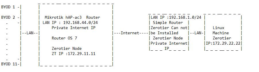

Use Case A: Using ZeroTier for remote management of RouterOS
This should actually work if both the iPhone and Mikrotik are joined to the same ZeroTier network as “Members”. You can use the ZeroTier assigned IP address to connect via webfig or Mikrotik iPhone app, assuming the iPhone has ZeroTier connected to same network. It really is that simple.
Firewall may be why this wouldn’t just work…
If you’re using the default firewall, you need to do something with zerotier1 interface to allow (“accept”) it. e.g. RouterOS firewall rules (/ip/firewall/filter) may block Winbox, SSH, etc. ports on INPUT from zerotier1 (since, by default, it isn’t part of the LAN /interface/list). Basically you need consider the ZeroTier interface (or IP range) and it’s effect on your specific firewall rules – otherwise it may be DROP’ed by the default firewall filter rules. Mikrotik’s example allows full access to the router from the connected ZeroTier network, while blunt, does work:
add action=accept chain=forward in-interface=zerotier1 place-before=0
add action=accept chain=input in-interface=zerotier1 place-before=0
But a better approach may be to put the “zerotier1” interface in a specific /interface/list like “LAN” (or “BASE”, “MGMT”, etc.) so it be allowed via an EXISTING set of firewall rules, and controlled via an “/interface/list”. In most default configs this would do the trick too:
/interface list member add list=LAN interface=zerotier1
And all smartphone/laptops/desktops/etc connected using a ZeroTier client app, that then connect to RouterOS over ZeroTier will appear using their ZeroTier-assigned IP address, via a Mikrotik’s ZeroTier interface like “zerotier1” – any these can also be used in firewall rules as needed to accept/drop traffic too. Certainly you can use more restrictive rules within the Mikrotik firewall (e.g. allowing ONLY winbox/ssh/etc TCP ports using “… chain=input in-interface=zerotier1 …”).

How to make Zerotier an Entry Node ( Reverse Exit Node)
We need to access a remote Linux zerotier machine, from our office room without installing zerotier on BYOD’s.
The zerotier setup may be exactly reverse concept of managed route (Exit node).
BYOD : Windows Laptops Without Zerotier Installed.
Without installing Zerotier on BYOD’s, they have to access Remote zerotier Linux machine.
We dont want to allow Remote machine to be accessible from outside of our office Room. So we can not install zerotoer on BYOD’s.
I am able to ping between 172.29.11.11 and 172.29.22.22 from both sides.
Please suggest the configuration procedure/Steps, including any firewall/iptables setup.
Thanking you.
