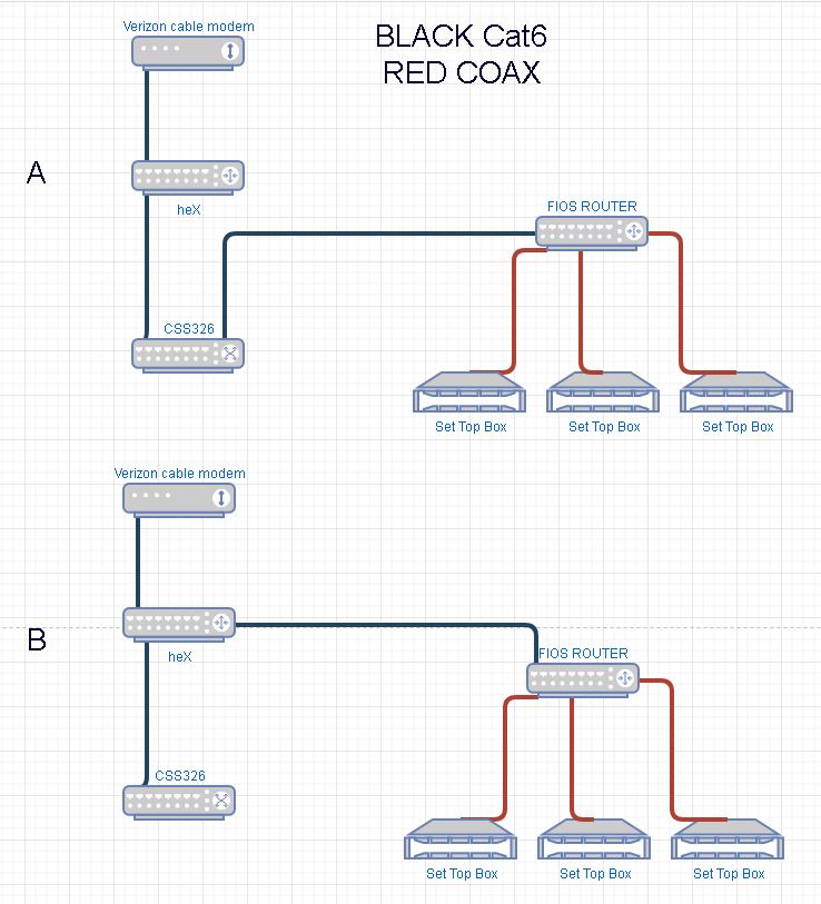

a) ether1 connected to cable ONT (WAN) – dynamic IP
b) ether2 (192.168.2.2) connected to CSS326 switch (192.168.2.3)
c) ether3 connected to Verizon FIOS router (192.168.2.1) acting as a MOCA bridge (I think that’s the correct terminology) so that ethernet traffic can pass via coax to set top boxes
I have a bridge interface (named: bridge) that currently includes ether1 and ether2.
I was thinking that in order to isolate traffic as effeciently and effectively as possible between (1) the FIOS router and STB’s connected to it and (2) the CSS326 and connected LAN devices would be to keep the FIOS router on a separate heX port (ether3).
Does this make sense?
Would I need to make a separate bridge that includes ether1 and ether3?
I understand there are multiple ways to achieve this (FIOS into CSS326 and port isolation; FIOS into CSS326 and firewall rules, for example).

Here’s a second try.
Right now:
heX ether1 is wired to the FIOS ONT and gets it’s IP dynamically from Verizon;
heX ether2 is wired to a CSS326;
heX bridge includes ether1 and ether2, and is 192.168.2.2
FIOS router is wired to a port on the CSS326 and is 192.168.2.1
I have port isolation configured on the CSS326 such that the FIOS router can only communicated with the hex (it cannot communicate with any devices on any other ports of the CSS326).
I’m wondering if it might make more sense to wire the FIOS router into the heX port ether3 and let the heX keep the traffic between the FIOS router and my LAN separate?
My understanding is that because ‘bridge’ does not includes ether3, the heX will not pass traffic between bridge and ether3 unless routing and/or firewall rules allow.
I can’t even imagine how I would accomplish this with VLANs (the FIOS router is not VLAN-aware).

Version A is how things are now. It works, but the FIOS router and the set top cable boxes are on the same broadcast network as all my LAN devices (connected to the CSS326).
I would like to separate into 2 broadcast networks: Broadcast network 1 (FIOS router and set top cable boxes) and broadcast network 2 (devices connected to CSS326).

Out from their modem come 2 cables: Coax and ethernet (RJ45, twisted pair, catX).
The coax at this point carries TV.
That coax gets distributed (in a trunk and tap/splitter kind of way) to:
a) Verizon’s router (model G3100); and
b) A bunch of set top boxes.
The G3100 has an RJ45 WAN port for internet access that is not being used.
It also has 4 RJ45s (logically, a switch), for devices or downstream switch.
The connectivity between the G3100 and the STBs (which need IP addresses and now get them via DHCP from the heX) provides internet access (all via coax) to the STBs and is necessary for online program guides, DVR, On-Demand stuff. Internet access is provided to the G3100 by a cable from one of its LAN ports to a port on the CSS326.
I have full control of the G3100 – I assigned its IP address, etc.
Now, back up to the modem:
A cat6 cable connects the modem to the heX.
A cat6 cable connects the heX to the CSS326, where all my devices are connected.

The heX is the one and only device performing as a router at my location. The G3100 only acts as a bridge between twisted pair and coax for the STBs.
Yes, I have another thread talking about Vlans and my setup. And, yes, Vlans have not yet clicked. But, I do have an understanding that port isolation is not the best way to accomplish my goal – hence the current thread.
Would it be more helpful to explain from a functional perspective what I want to achieve or from a network layout perspective?
