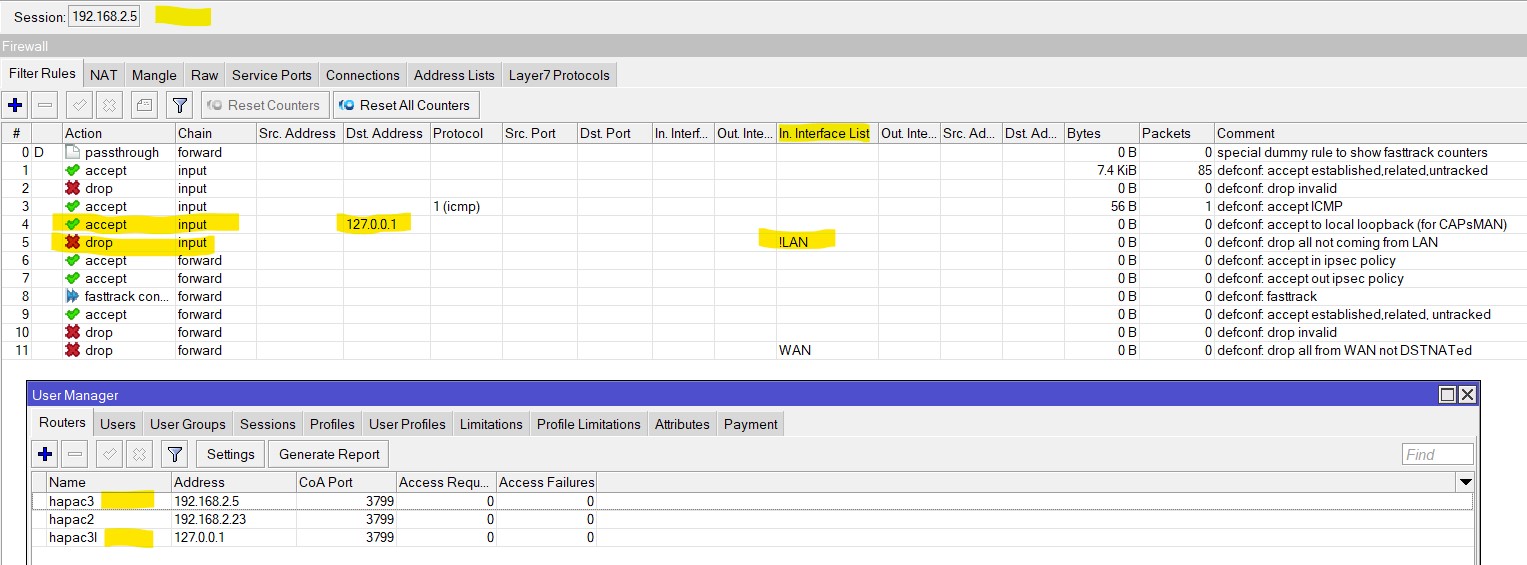

You could also use 192.168.88.1 instead of 127.0.0.1 in your setup, if ether1 is member of the LAN interface list. (see Firewall rules)
E.G. my setup for wifi WPA2/enterprise (EAP) authentication
