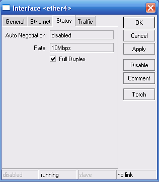

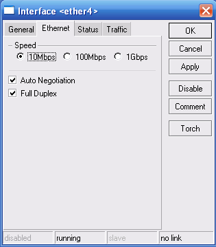

PS: i think i find the problem. see images.
can i enable it?
Cool! I like to play with stuff too…
Well if the tick is set in the auto-negotiation then it should be enabled. I see that you have it ticked and it still says disabled… hmmm…
Perhaps instead of trying to auto negotiate you could set and force each end of the link to the speed and duplex you want. But chances are you tried that already.
IMHO this is starting to look like a driver issue…
