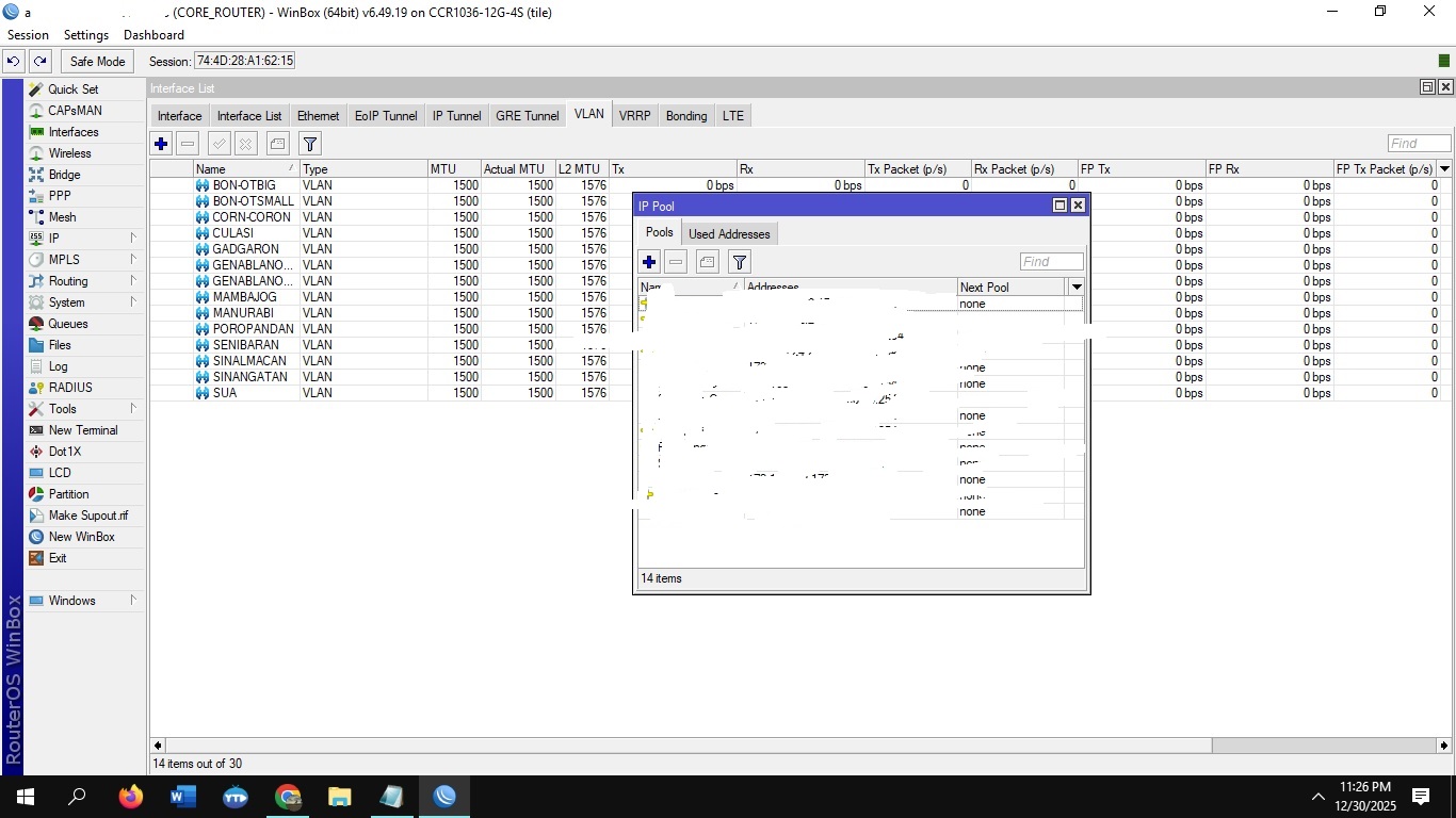

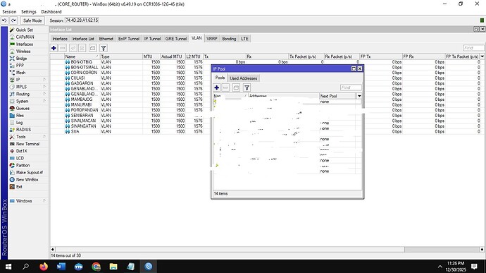

HI All,
I just want to ask if my router support 10G, model: CCR1036-12G-4S

Have you checked specs here before asking the question? https://mikrotik.com/product/CCR1036-12G-4S-149
No 10Gb ports available.
BTW. Picture was unnecessary.
If you look at the Spec you will see that device has only 4 SFP(1G) ports, not SFP+.
Sadly top of this page: https://mikrotik.com/product/CCR1036-12G-4S-149#product_specification
Says : SFP/SFP+ that can be misleading
Check product pages.
12 Giga ethernet ports and 4 SFP ports (not SFP+).
So I would say: no.
It can ROUTE over 10G, yes. But it can not handle a single 10Gb interface.
Unless the routing part was your question ?

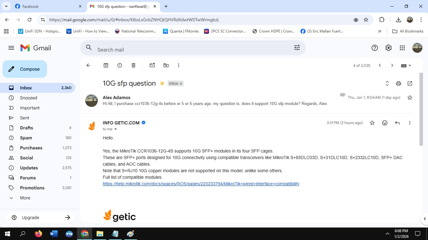

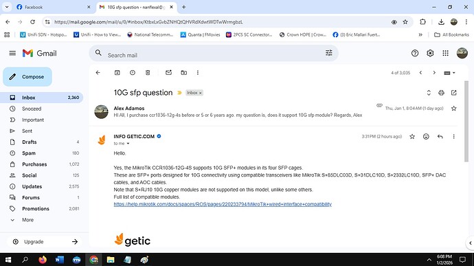

But the question at hand is - I believe - to be split into two different ones:
  1. would a s SFP+ (10 Gb) module work in a SFP (1 Gb) cage?
  2. will it work at 10 Gb speed or ONLY at 1 Gb speed (if supported by the 10 Gb module)?

@jaclaz, your two points are kind of a "lawyer's perspective" - the answer from Getic may be formally correct if the 12G-4S device indeed accepts 10G modules, even though they cannot actually operate on 10G speed, but common sense says that's not what @Nanflexal was asking. So if someone purchased the 12G-4S based on this response, they'd definitely have grounds for a return.

CCR1036-12G-4S specs states:
Fiber
  • SFP DDMI: Yes
  • SFP ports: 4
No mention of SFP+ so it implies no way to work at 10Gb even if you can fit the SFP+ module in.

Well, the official Mikrotik documentation does provide a list of 10 Gb modules "compatible" with this device ( in practice all BUT the S+RJ10)
which can be ambiguous, without a note like:
[*] this model has SFP ports, connection speed cannot exceed the SFP max rate of xxxx.
BUT the Getic reply is NOT correct when they say "These are SFP+ ports designed for 10 gb connectivity ...", those ports are SFP, NOT SFP+.
